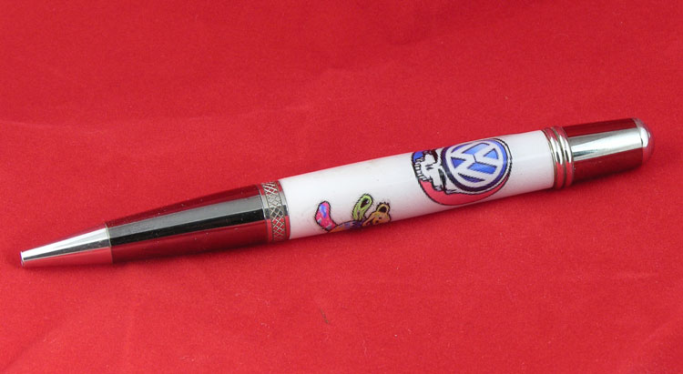

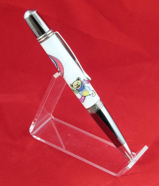

So why not use a white background and clear decal paper, you can paint the tubes white or mix up some white PR, turn it down then apply the decals then put the CA on.
This was done on a white powder coated tube the decals which were done on clear paper with an ink jet and sprayed with two coats of Krylon crystal clear acrylic were applied then painted with CA, then cast in one of New London 88's Resinsaver molds, it's extremely easy to do and the results turn out pretty good for an old hack like me.
