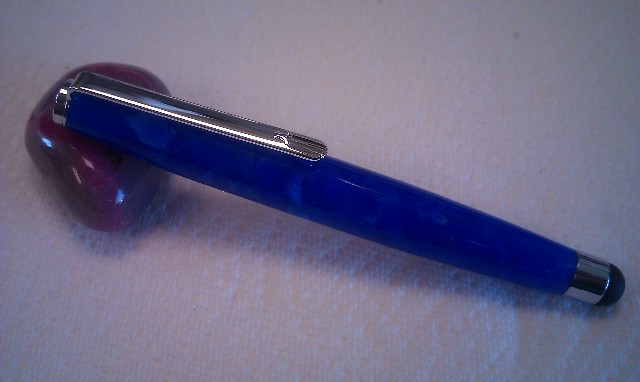

I made some stylus's for my daughter, son, & wife to use on their tablets.

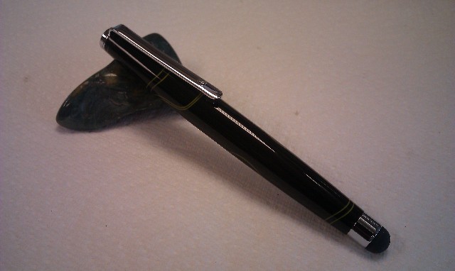

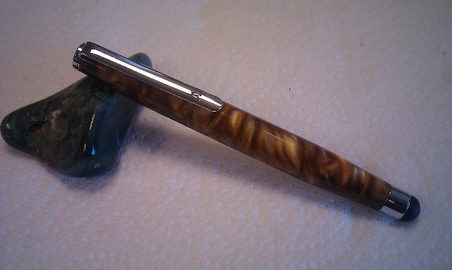

  • Gold & Brown Stylus assembled with Chrome plated components 002 Large Web view.jpg

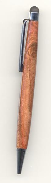

Hey James, heres what a combo from a slim kit looks like done up as a single barrel. Turned it between centers with no bushings, what a pain with no brass on one end.
Looks good Gary. I have some kits that are just the stylus tip. I need to convert them to fit the larger tubes for finials as I don't turn many 7mm pens.

Here ya go........
  • Royal%20Blue%20Stylus%20with%20Chrome%20plated%20components%20002%20Large%20Web%20view.jpg

The 7mm makes a good slip fit into an 8mm tube so it should be easy to adapt to an 8mm kit with the help of some thick CA. Bigger would take multi sized holes, say 7 on one end of a blank with say a 10 part way through from the other end. Love to see what you come up with.

The center one is too small for me to do much with, here is your third pic, with some minor adjustments.
  • Gold%20%26%20Brown%20Stylus%20assembled%20with%20Chrome%20plated%20components%20002%20Large%20We.jpg
