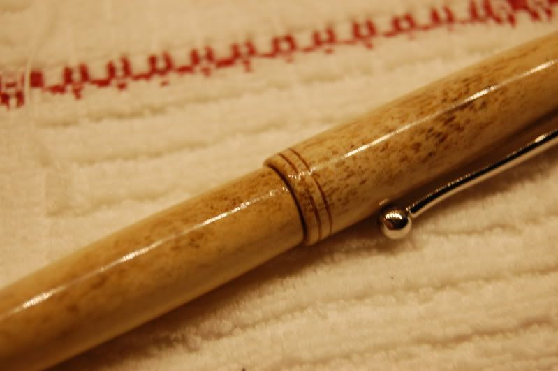

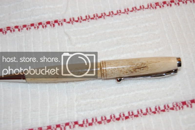

here is my latest slim. I left out the centerband and cut the decorative lines with a skew. Kinda of made a mini-euro from deer horn. just giving another look
