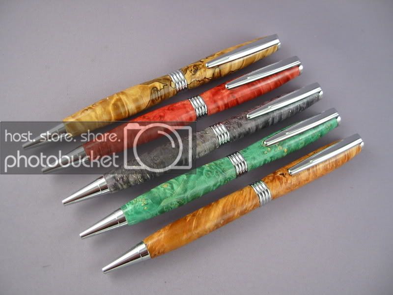

One of my frustrations as a pen maker has been finding a pen in the 7mm slim line category that I think suits my style of pen making. I know many people like the traditional slim line but I have not found it to my liking.
As a seller of my work I have also seen the need for a slim pen that looks just right. I think I have finally found the kit that works for me. A few weeks ago I was in the Burlington Lee Valley and I noticed a pen kit called the Streamline. I had not seen it before and I liked the look.
With a show coming in a week I bought 10 kits and decided I will see how they do.
So here is the result of today’s turning.
These are Flat Top Streamlines
They are all stabilized box elder burls, spalted, red, black, green and brown

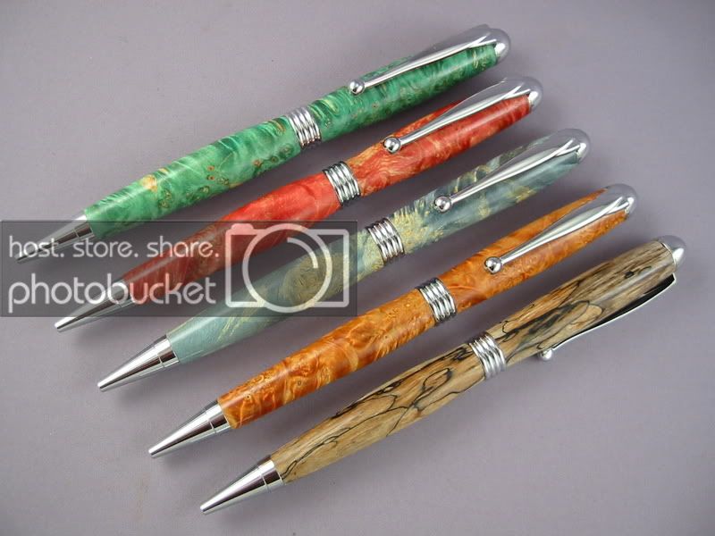

These are the Round Top Streamlines,
They are a variety of colours of stabilized box elder burls and a spalted oak.
I am really happy with the size and appearance of these pens, I think they will do well

Nice pens!!!
Woodcraft has a pen they call the Toni, that is very similar to the flat top, I just wish they sold more than gold finish. I'll have to take a look at the streamline so I can get more finishes.

Jim, the pens look great, and I agree...that's a very interesting kit. I'll have to keep a lookout for them once my SL's are gone.

They all look great Jim. Is the round top from Lee Valley as well. I haven't seen it before. Is the show you are referring to the Kitchener one? I am hoping to get to that one to wander around for a bit.

Just for info, they are both Berea kits and sells very very well. I replace the slimline by this kit a while ago. If i recall, Russ Fairfield uses mostly this kit, altough he dont uses the centerband, he prefer the stremline clip over the slimline.
An other good slim replacement is the confort kit and now comes in a whide variety of plating.

Great looking pens, Jim. I really like that spalted Oak. Let us know how they sell for you, since I have the same feelings as you about the standard slimline.

The clip on the spalted oak seems to have been pressed in incorrectly. From my vantage it appears to be twisted to the right about 90*. [:D]
Great looking pens, I may have to look into this kit too.

Great looking pens. I have built a few of the round top ones from lee valley. They allow the builder to show off a lot of wood in a simple good looking kit. I have sold a few of them. Good luck with your show.

I love the look of those pens. Are they bigger in size then the SL? They look a bit larger. Where did you get them?

They are more robust in diameter than the traditional slim line...the centre band and the round top diameters enable the pen size to be larger.
I live near a Lee Valley store and bought them there, you can order on line. The flat top and the round top use different bushing sets. Still a standard 7 MM drill for both. The lower barrel on teh Rt is longer than the FT.

I had to go back and repair that one, the spalted ones are always different eh!![:0][:0]

Beautiful pens! The streamline is one of my favorite kits. I prefer the chrome. Now if I could make pens as nice as you do, I'd be set!

Great looking set of pens!
I'm also not a big fan of the straight slimline and have been using the "comfort" kit without the rubber piece. I think that is about the same size but with a simpler center band.

I've recently done a number of the "streamline" pens ... and they do look nice as the photos indicate. I've done Titanium gold and black ... got 'em where I work, at Rockler.
They are nice for those who prefer the smaller pen size.

Love your pens, they're great looking! I have used the Streamline from the beginning. I have never really like the Slimline because it too small. The Streamline it a bit bigger and shows more character of the wood. It's a great kit!

Fantastic work Jim! as all ways also l love your finish Jim. Can you let us know how you finished your pens' also with the round tops pens do they have a longer tube nib end or is it just photo making them look longer.last [?] what platings are they, Normally with a bunch of pens l can pick out one l really like' but not with this lot' they all look so good l don't think the dust will get to settle on this lot[;)][:p][:D]

John, I order mine from AS. The plates are chrome, gold and several others. If you go to AS website, click "Berea pen kits images" and I think they are listed on the 4th page. And yes, the nib end tube is longer than the clip end tube. I also use the Streamline centerband to add a little pizzaz to my bullet pens.

The finish is just the way I finish stabilized woods and plastics.
I turn with a skew so I make a very smooth continous final cut to eliminate tool marks (skew honed just prior to this final cut), I wet sand with Abralon (500-4000), then I wet sand with MM (4000-12000), I then use a scratch remover (Novus 2, Russ also says Brasso Works). That's it![;)]

The tubed for the flat top Stream lines are equal in length...The round top are different, the top tube is the same length as those in the FT but the lower tude is longer and I suspect that it is very close to the lower tube length in the Euro pens.
