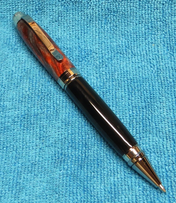

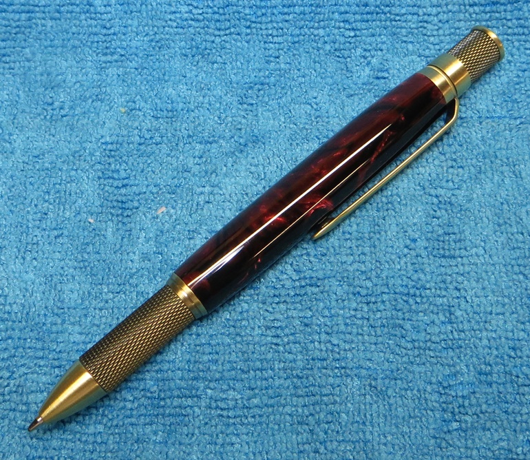

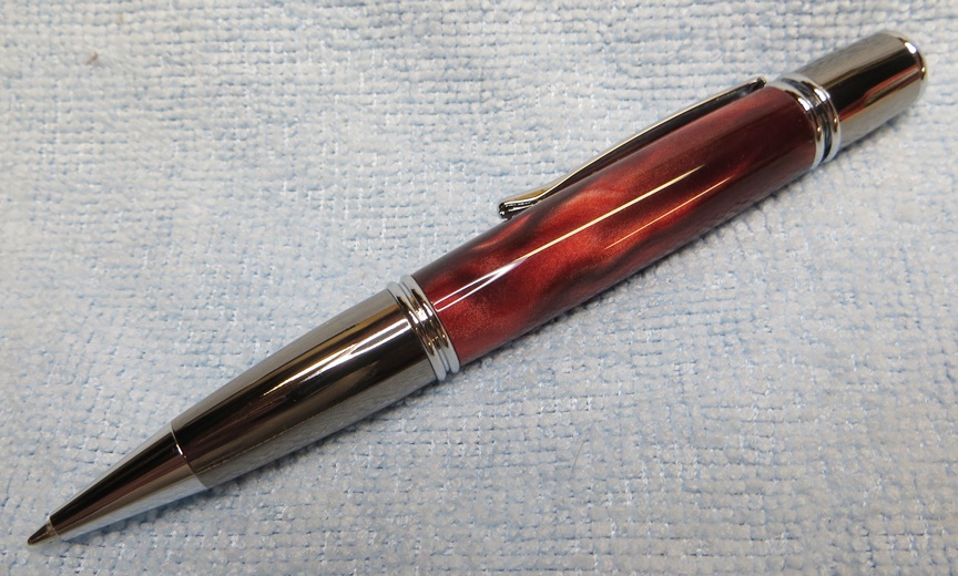

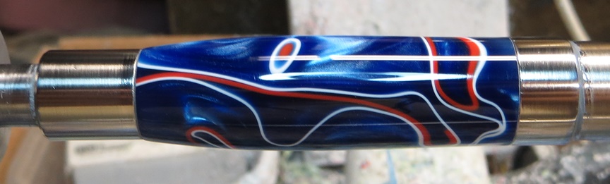

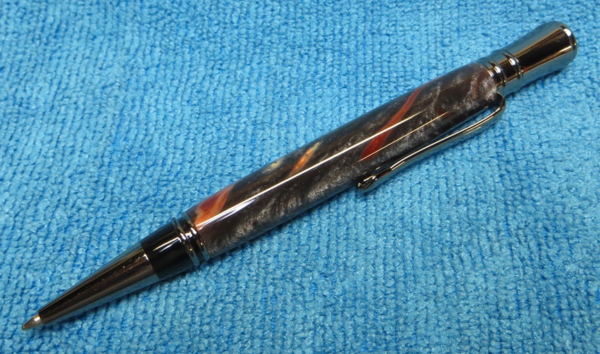

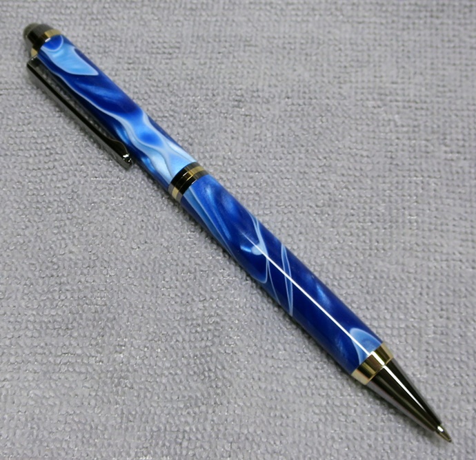

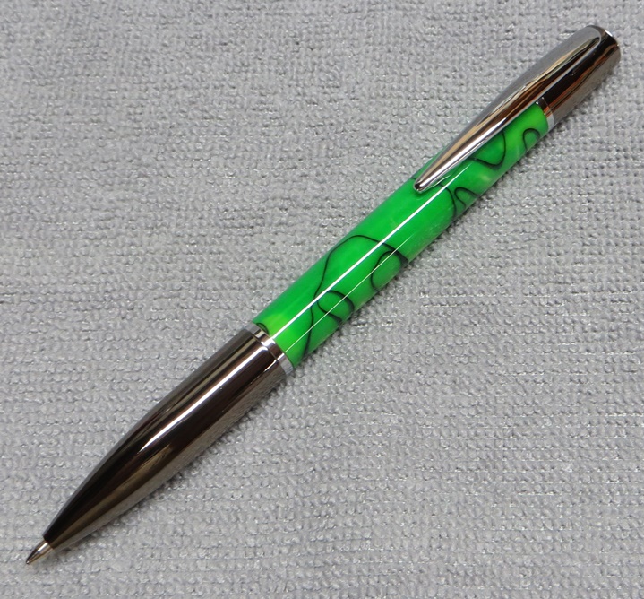

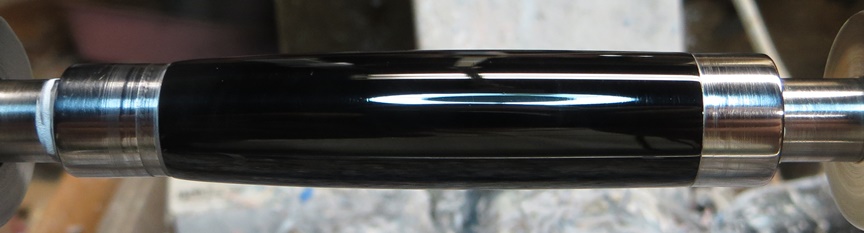

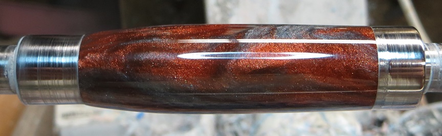

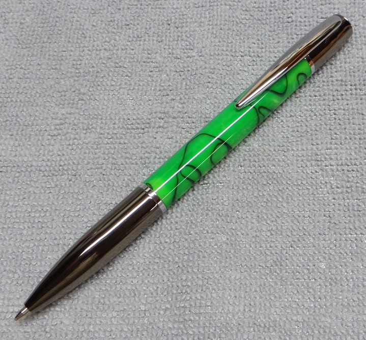

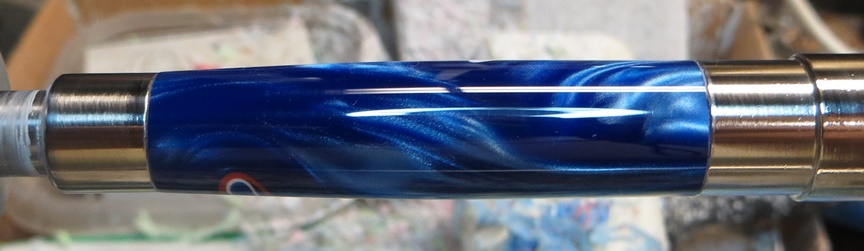

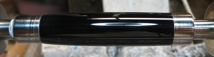

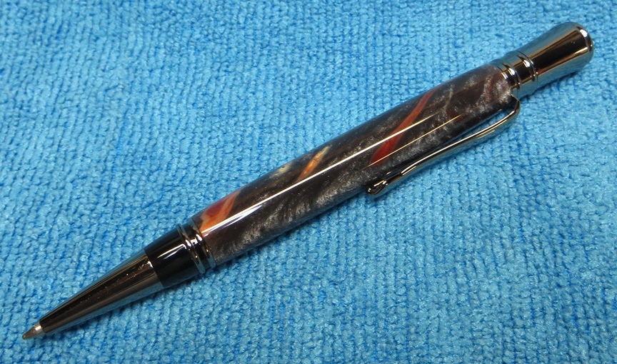

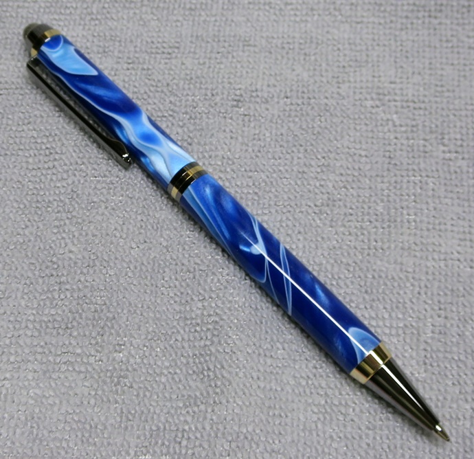

Like CREID said, it's personal preference. For me, the criteria is the design of the pen. For longer, thinner pens, I generally turn them straight. For shorter, especially single body pens, I generally turn them with a bulge. One thing I don't like at all is too big a bulge, or a "fat" pen. But that's just me, a lot of people do like them.

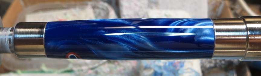

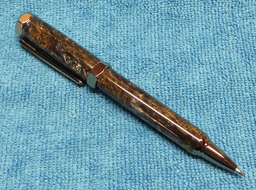

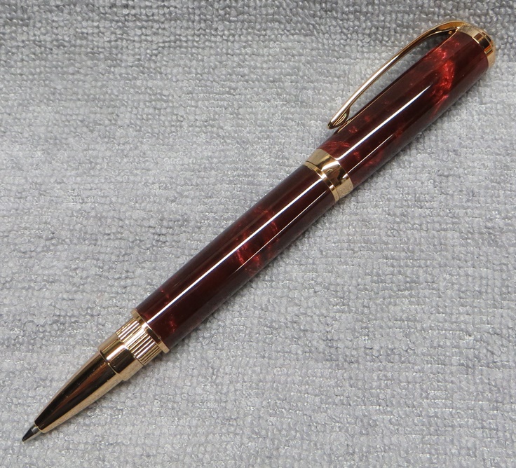

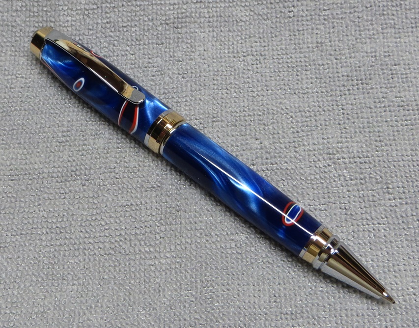

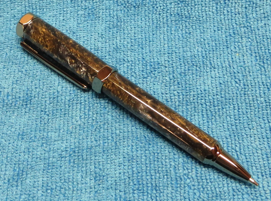

For some pens, though, I neither turn them straight nor with a bulge. One style that comes to mind are the Cigar and Big Ben pens. Since the bushings are different sizes, I turn them with a profile that transitions the smaller diameter into the larger diameter.

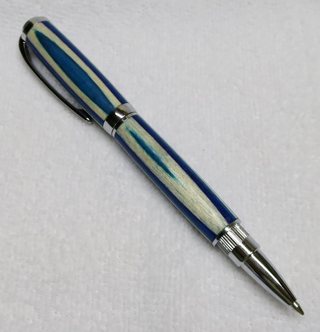

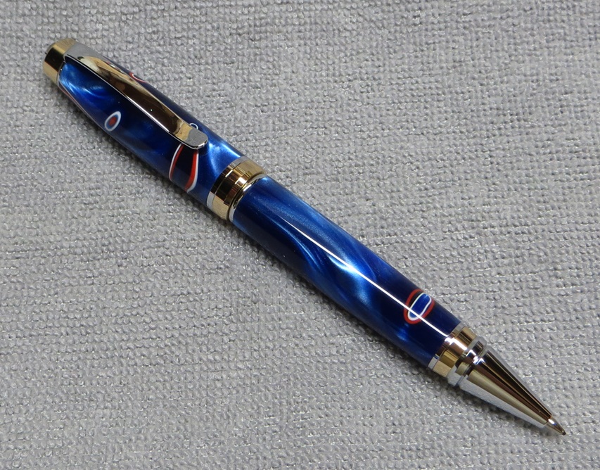

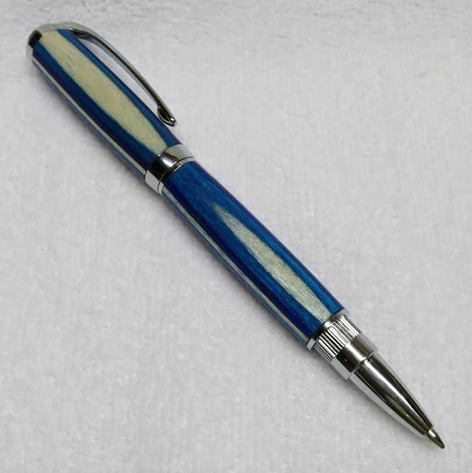

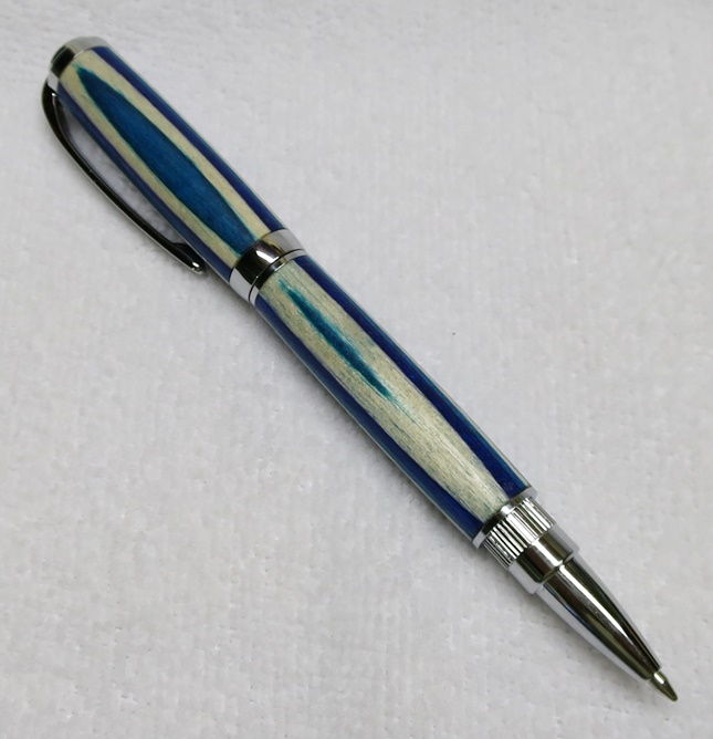

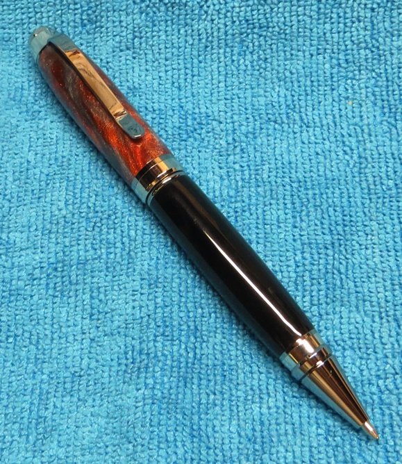

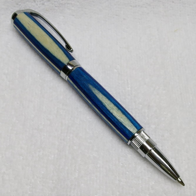

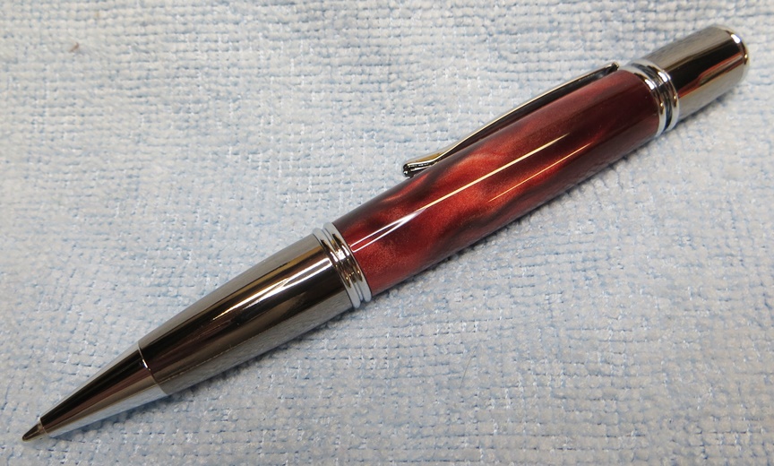

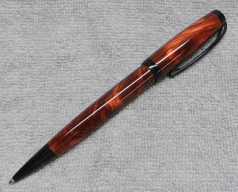

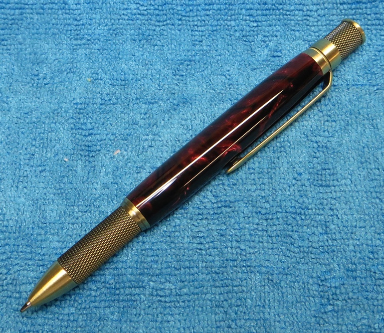

To throw another twist into the works, with some pens I'll turn a bulge in the upper body, but a profiled or straight lower body. Some that come to mind are the Graduate, Post Graduate, Rinehart, and Apollo Infinity. Once in a while, though, I will turn bulges into pen bodies for a specific reason. The last pen, another Post Graduate, I turned bulges in both bodies to accentuate the stripes in the SpectraPly blank.

I'm still pretty new but quickly found I prefer straight, especially on a larger diameter pen. After seeing that last post by qquake though, a bit of a bulge on the top barrel only looks really nice.

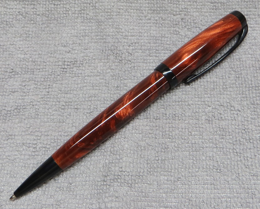

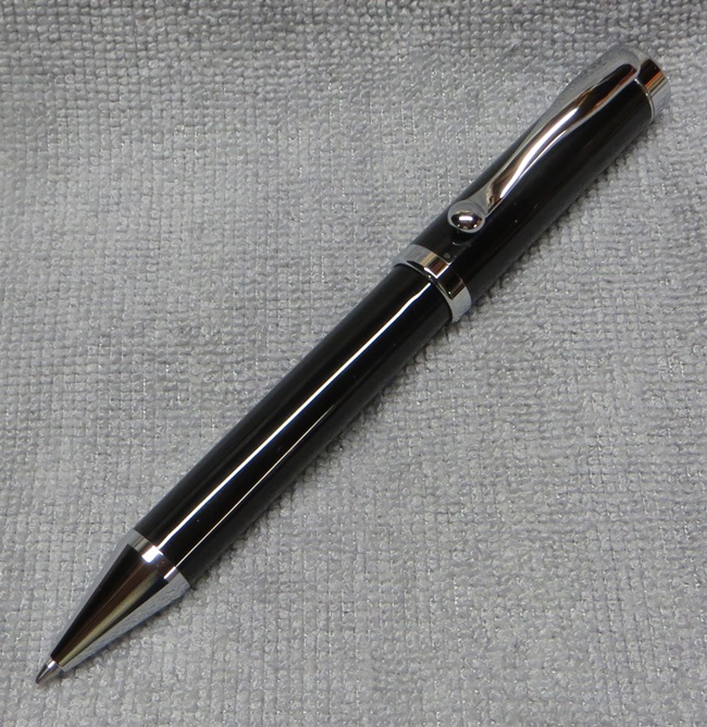

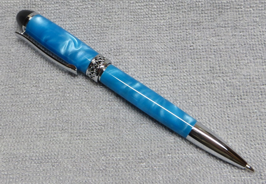

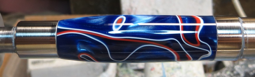

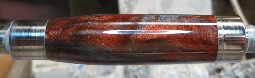

I turn a bunch of sierras. When the blank screams female buyer I try to make it straight so it is not too fat. For pens intended for men I make a slight bulge or make it straight. Sexist yes, but it seems to work. I do not like bulgy pens.
This simstone is as bulgy as I get.
