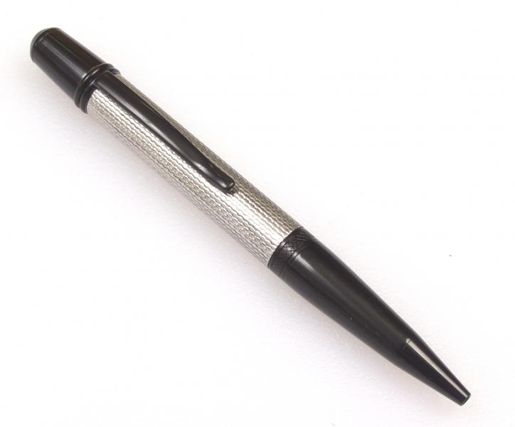

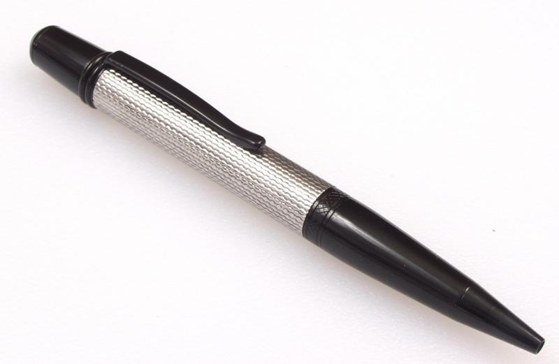

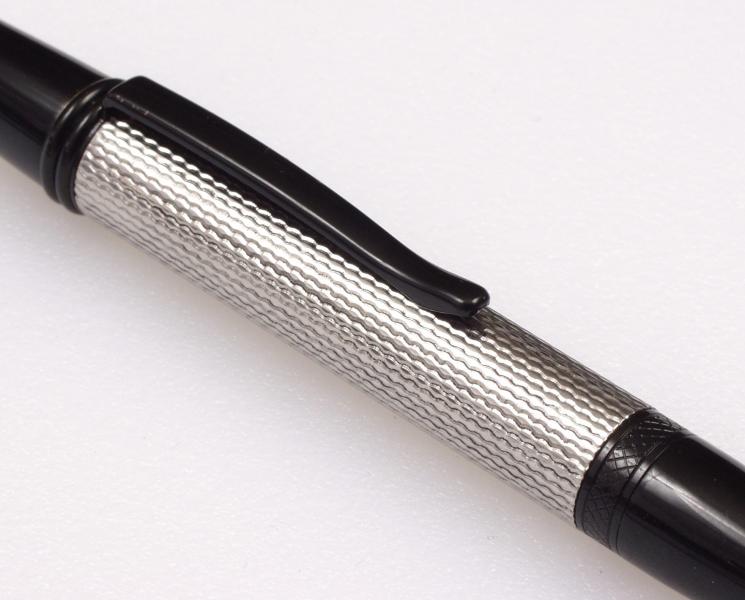

Hello To All,
I do not post often... so I thought I would show a pen.. The pen is made on a Plant Straight Line machine. The material is stainless steel polished prior to cutting the pattern. It is very hard to photograph the reflectivity of this kind of work. When you look at the pen it has a diamond pattern
comments welcome

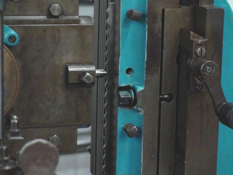

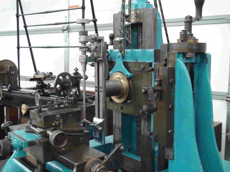

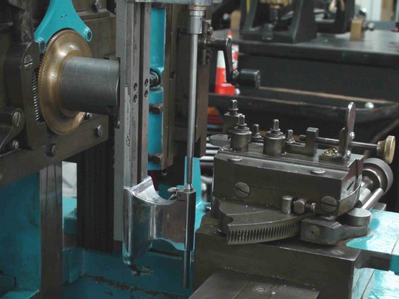

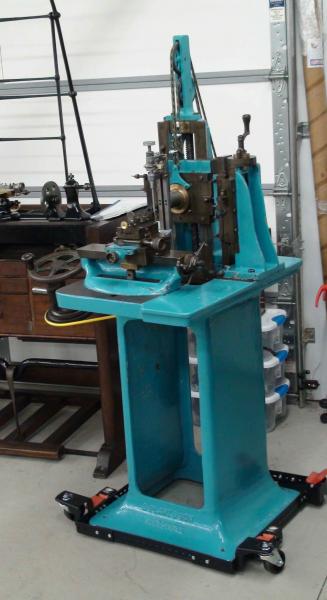

attached are photos of the straight line machine I used for this pen. The machine is made by a company called George Plant from England the machine was built around 1910. The machine is hand cranked and manual pressure is applied with the cutter to make the patterns
The first photo is the overall machine.
second is a up close of the pattern bar i am currently using,not the one for the pen shown.

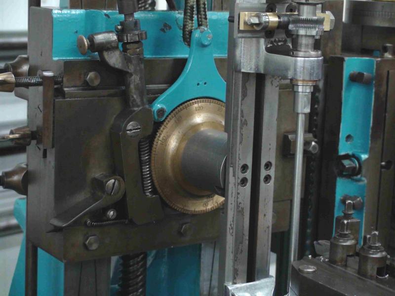

third photo is showing the pen chuck and the slide that rocks back and forth via the pattern which move the pen chuck back and forth.
forth photo shows the pen chuck i made it has a worm drive at the top that i made to make controlled moves
fifth photo shows the cutter that makes the pattern
