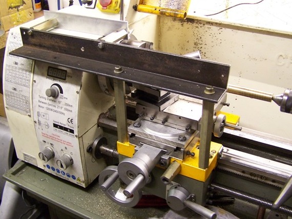

One of the UK guys ( the turning circle ) recently introduced me to Rose Engine Turning. While doing some reading up on the subject I came across Straight Line Engine Turning and I thought this method was easiest to adapt to pen making.
Here is a prototype lathe attachment that I came up with. It's pretty basic but works ok. I did have to make a special indexing dial around the big chuck which has 5deg increments ( 72 points ) This was the most difficult part to make and I even popped a resistor in my VS controller while doing a parting cut to split it in half.

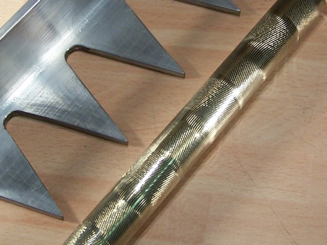

I read that the cutters need to be razor sharp and polished to work properly. I need to work on that.
The 'sparkly' bits in the cuts on the brass practice piece is actually where the brass has ripped instead of cut. But brass can be like that and it cuts clean on stainless. I just need to get the sharpening correct.
The aluminium zig-zag guide created the wavy 'moire' effect in the brass.

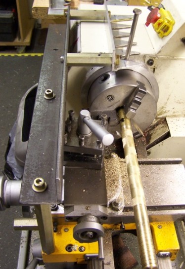

For this practice, I used a HSS 60deg threading bit on it's side. As you can see in the second pic, I've turned the toolpost to give me a about 8deg rake. I figured that until I can perfect the sharpening that the rake might help. All the info I have read shows zero rake. :confused:

When you make your cutter 15 degree on the left 10 degree on the right with a 20 degree neg rake off the bottom. I have a straight line ... keep the 10 degree side close as possible to the edge to be close to your guild.
I like your results......
take a look at a straight line machine..from what i call tell....what your photos show is not how straight line work is done.
if you need help ask away
