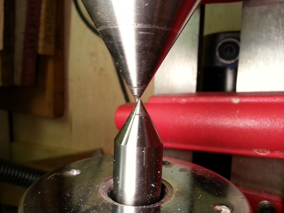

After having too many problems with pens ending up out of round, I just switched to TBC and what happens? My first TBC pen is more out of round than any other. This is absolutely maddening. I have a lot of trouble drilling my blanks exactly on center on my drill press, and haven't yet spent the money on the chucks to drill on the lathe. Would slightly off-center drilling cause such OOR issues? I'm also wondering if the problem is with my lathe. I notice that the points of the centers don't line up exactly when I slide the tail stock (picture below shows how the points misalign) toward the headstock. I have a PSI Turncrafter. Are all lathes like this?

No, all lathes are not like this. Your points should be dead on. As said above, barring any other issues, this is your problem. If your lathe is still in warranty, get on the phone with PSI ASAP.

Leslie, I have the same PSI lathe and think the headstock needs adjustment. Your photo seems to show it needs to be moved back a bit. The photo shows one of the allen wrench bolts too. I would relieve the belt tension and then tap it gently and tighten the bolts. Now plan B ...

No, I mean that when I slide the tail stock toward the head stock, sometimes the position is perfectly centered and sometimes the tail stock is slightly off to the right. I can lock it down in either position, but when I have a blank between the centers, it's no longer possible to tell if the points of the centers are perfectly aligned.
Can you take some pictures when it's perfectly centered, and when it's slightly off to the right? I'm most interested in how the base of the tailstock fits in the groove of the bed.
I'm trying to replicate the problem, but I can't visualize what you're experiencing.

After taking my lathe over to my turning club president's house--a master turner and former turning instructor with 19 year's turning experience, membership in 3 turning clubs, and 6 lathes of varying sizes in his shop--here's what I learned:
1. The tail stock in my Turncrafter lathe has an abnormal amount of play in it as a result of it fitting too loosely in the channel. Yes, many wood lathes have a bit of variance in the fit of the tail stock and will move just slightly in the channel, but mine has too much.
2. My OOR issues may or may not be caused by this, depending on how I move the tail stock toward the head stock each time I turn.
3. I have been using my mandrel incorrectly because I was not tightening it down adequately. This caused the mandrel to vibrate in the maxi-mandrel shaft and mandrel saver.
4. If I choose to use my mandrel, instead of TBC, I can be confident that my mandrel is not bent (he tested it).
5. The PSI tech i spoke with was giving me the runaround. PSI should replace my poorly fitting tail stock.
