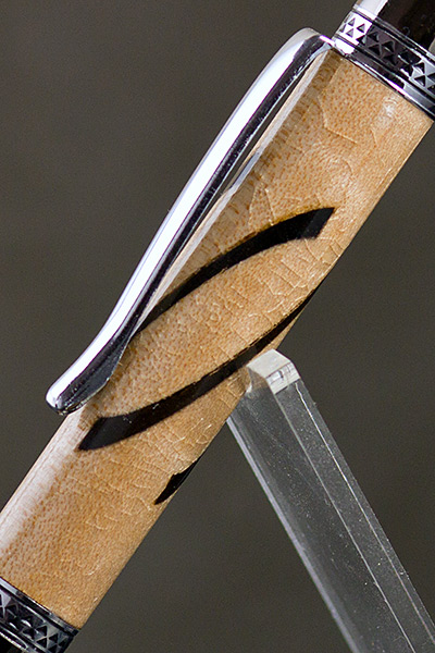

Well, I'm hesitant to blame Stick-Fast brand CA or Accelerator. I've only used E-Z Bond brand, and the same thing just happened to me.
I made this pen last summer as a demonstration of how to do "Eagle Feathers" for the local IAP chapter. I know it hasn't been dropped or left in the sun because I've kept it in a pen binder indoors. About a week ago, I took it out and saw this:
attachment.php
Six months later, the finish has shattered like safety glass.
I don't know why it happened. I suspect that the problem was caused by movement of the wood (although you'd think that the maple would be pretty stable). The finish is cracked around all the blackwood inlays as well. I have many other pens, however, that were exposed to the same temperatures without issue. The finish is fairly thick, so that may have contributed to the fractures.
I might consider going back to using BLO, as that might make the CA more flexible. A thinner finish might also be less brittle.
