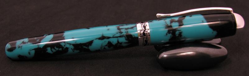

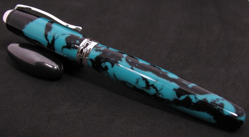

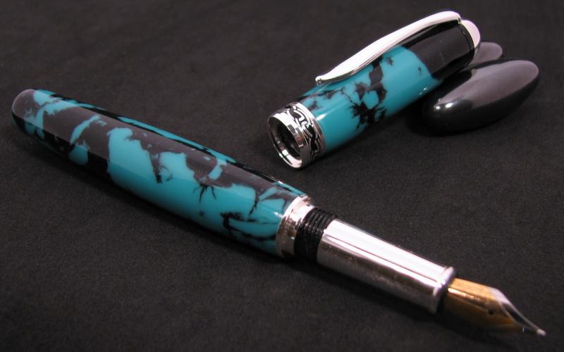

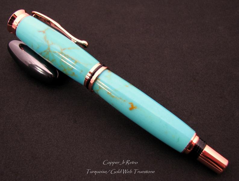

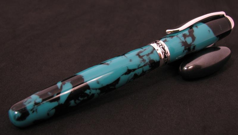

Well it is a Sterling silver Sedona with a black and green turquoise hand cast resin. I have had several booboo`s like this but really like the effect it gives. It is black PR that was still liquid and Turquoise that got a little jelly like,while doing other things. All I do it put the blob in the mold pour in the black and take 2 Popsicle sticks and cut the blob and drag it each way through the mold. It wants to keep springing back so I just had to keep trying to cut and drag till I had a full coverage of Turquoise through the whole mold and this is the result. I made it a closed end and it was sanded then sanded again through all the colored pads then polished with heavy and light scratch remover.
The pen itself has more green in it like turquoise . I cold not get the camera to duplicate the colors.
Tell me what ya`ll think goo,bad or ugly.

+1 Mikey likey, he likes it he likes it!
I've lost 2 or 3 turquoise pens, often a pen that gets a LOT of oohs and ahhs.
Keep up the booboos, you are on to something there.

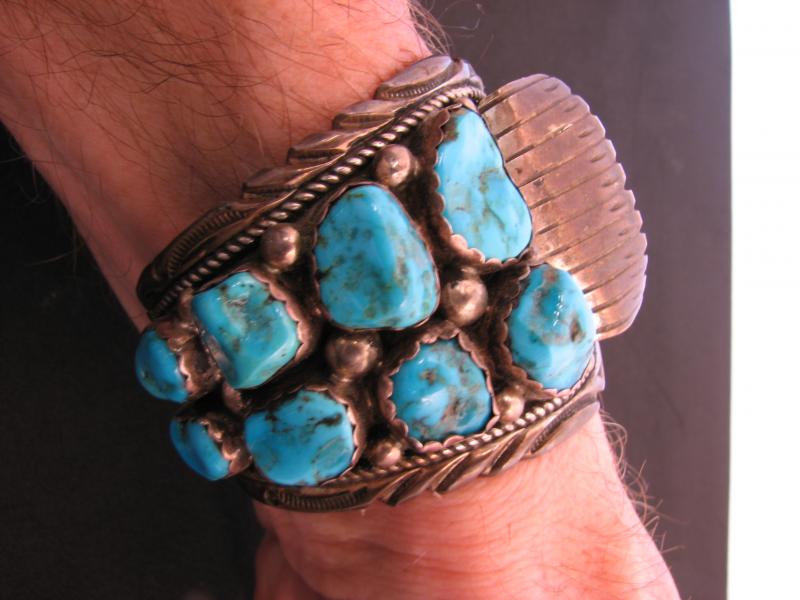

Thanks everyone for the comments. I really like the way it looks and love Turquoise. My wife doesn`t like turquoise so much, she thinks its gaudy.
I even have a belt buckle that is similar in design as the watch cuff
