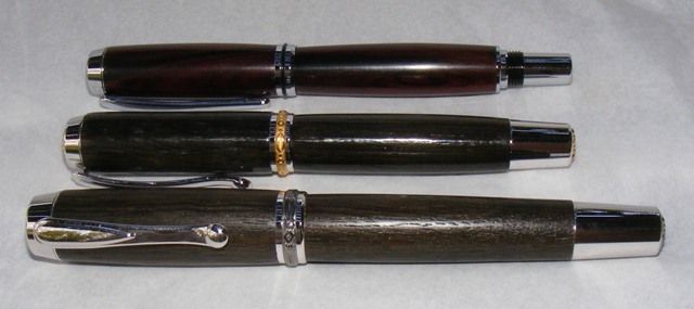

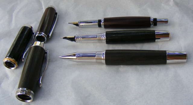

This should help clear it up.
Top is a Baron
Middle is a Jr. Statesman
Bottom is a Statesman

Sylvanite
Jul 18, 2006
3,113
Hillsborough, North Carolina, USA.
If so, the statesmen are the same size as these pens, just more bling and more expensive.
Precisely. The Gentleman and Statesman pens are the same size (and use the same bushings). The Jr. Gentleman and Jr Statesman pens are the same size (and use the same bushings).
Here is another picture showing both the Statesman and Jr. Statesman pens:
I hope that helps,
Eric

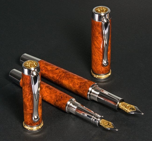

Eric,
That's also a beautiful set!! Hope you sold it as a set, someone should have paid a pretty penny!!
Excellent work.
