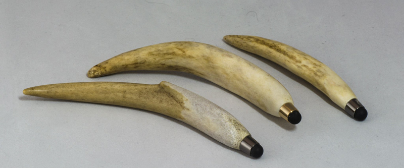

Rikon offers a large drill press with almost 5" of quill travel. Works great! Harbor Freight has a very similar looking drill for less money (I have no idea what the differences are, but it's clearly the same castings, etc).
Powermatic offers one with even longer quill travel but the price is likely higher than that of the Rikon.
My little Jet 1014VS sometimes drills great and sometimes creates more problems than it solves.
Plus, since the lathe has to spin the blank when you drill there, it's much more difficult to use the lathe to drill certain funky blanks like antler tips where the blank is curved in ways that make them NOT what you want spinning during drilling (like the bottom two in the enclosed picture).
