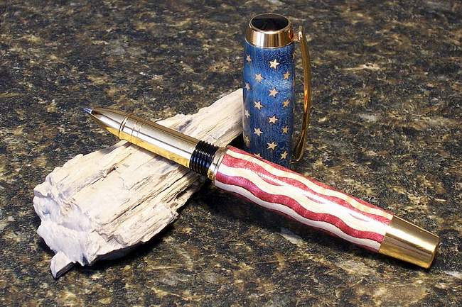

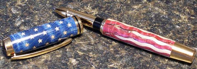

This is my first pen in about 2 months, the LOML has been keeping me busy with other projects. I didn't get a couple of the stripes seated all the way and when I was gluing them in the wood came loose from the tube on one end. I put CA between the and tried to center it but found that it was off center when I turned it as you can see in the second picture.
I had planned on putting it on a Rhodium/black titanium Statesman but will wait until I get another stripes tube and get it done right.

As far as gluing in the stripes is concerned. I think I did follow Ken's instuctions. I thinned yellow glue to the consistency of cream (wasn't sure if that was thinner cream like you use in coffee or heavy cream). I brushed glue in the recess and on the stripe. I let it set for maybe 10 to 15 seconds to hopefully soften the wood. Then I used the barrel of an exacto knife to press the stripe in. I bought 8 little clamps from Home Depot and used them as in the photo.
I'm not positive that the 2 stripes that I sanded through were not seated fully. It was hard to tell but that is what Ken thought.
The red wood did come loose from the tube and I had to put thin CA into the gap. Then I tried to hold the wood in such a way that the gap was even all the way around while I sprayed it with accelerator. Part of the problem (maybe the whole problem) was that it did bulge out on one side.
I assembled the pen with Gent Jr kit until my new stripes barrel comes, then I will disassemble it and put it with my Statesmen Jr. kit.
