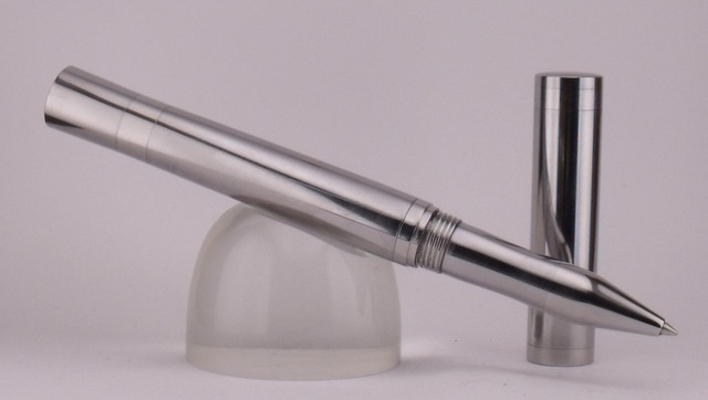

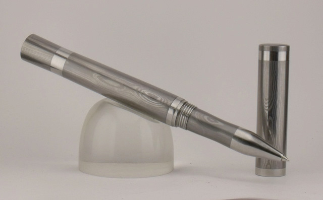

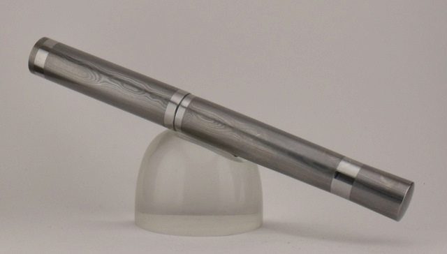

It's been a while since I made a pen but I received a chunk of real damascus steel from a good friend, in a trade, so I had to make it.:biggrin:
( Many thanks, sir!!:wink:)
This has stainless steel trimmings. The 'Before' pic is once it was all turned and polished. I used white wine vinegar to 'etch' the grain back in.
I believe there are beter chemicals / acids to do this and they give a better contrast, but all the ones I found said that they would also react with the stainless, so vinegar it was.:rolleyes: I may put it back in the vinegar overnight, but I do like it the way it is. I 'might' also eventually make a stainless wire clip too.:rolleyes:
Hope you like it too and any c&c's welcome:biggrin:

dang that's nice! like the nib/handle shape. is the tail slightly flared or is that camera angle?
Yes Jon, it's flared a bit. In fact only the cap has straight sides as the blank was the same size in the square.

The pen is awsome! The photos, on the other hand are truly amazing! Trying to get detail on metal is difficult at best, but to gather the detail on Damascus Steel that well is OUCH, tough. congratulations on a very amazing and beautiful pen as well as the very informative photos.

You are the man Skip. Real damascus has to be one of the haardest materials to work with from what I've heard. Its a real beauty.
Thanks Bruce, but it wasn't that hard to turn. But as it is laminated layers, I struggled to get a nice 'finishing cut' I had to do a load of sanding.
The chips were tiny, sharp and HOT!!:eek::rolleyes:
Threading the cap with a tap was very easy ( threads are 12mm x 1mm )
Thanks again:wink:

What i want to know is how you are mating the stainless to the demascus?Surely they are not epoxied together.Also,are you using tubes and just press fitting the parts together,with such close tolerances that the seams are not visible to the human eye?

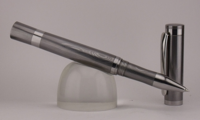

...... Get a clip on it though, saves it rolling off the desk! :biggrin:
Ok Mark :wink:
Here it is with a Baron Clip. Looks ok but I'm gonna see if I can recess it so you don't see the join line. If I wreck it, I know where you live!!!!:biggrin:
