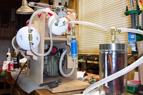

This is my vacuum system built with a pump from ebay and design suggestions picked up on Joe Woodworker's web site. It works quite nicely and I can pull up to 27" Hg of vacuum with it.

That is quite a contraption!!!! What was the name of that place?? River Ridge something??!!! Thanks to everyone for their responses!!!
