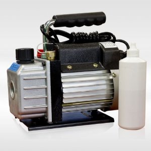

I got a cheap vacuum pump off of amazon, and it works fine I've done several runs with it, ya just have to change the oil regularly.
Vacuum Pump Rotary Vane 2.3 CFM 1/4 Hp

For the size of vacuum pump, you want to be looking at how much vacuum it is capable of generating. Most rotary vane (oil filled) pumps will pull 29" Hg at sea level. This is a really good, deep vacuum for stabilizing. Don't worry about the CFM rating of the pump for stabilizing. Higher CFM rated pumps will not generate a vacuum, it will just get you there quicker. However, the chambers we use are so small in regards to the volume of air in them, that the difference in time is seconds. Then you also run into the limitation of how much CFM the hose itself can carry and with the size hose typically used, anything over 3-4 CFM at the pump is doing nothing at all for you.

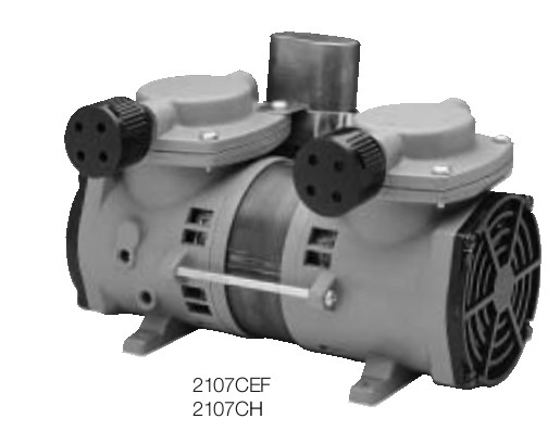

Using a paint pot for the vacuum chamber and a Gast vane pump I get 23 inches of pull. I have adjustment knobs and can get more but this works and I see no reason to mess with success.

I purchased a 2 stage 3cfm Vacuum pump from harbor freight and it has functioned flawlessly for 100+ hours of actual use, just needed to change/fill oil from time to time to keep the optimum level.
I ordered a good vac gauge online and it actually works properly and I pull 28.75hg vacuum with no problem at 993ft elevation. The max I should be able to pull is 28.9 since my gauge doesnt show tenths its a rough guess im pulling 28.75, could actually be higher. I keep the wood submerged, run vac until I see very few bubbles floating up then I shut off the pump and allow the pressure to drop gradually on its own. If I'm not in a hurry I leave the wood to soak awhile. I place the blanks on a rack on a pan in my kitchen oven and bake 1-1.5 hours at 200 degrees, remove and allow to cool, then turn. The smell from the Cactus Juice cooking off isnt too bad, I run the exhaust fan above the stove and it keeps it minimal. When finished I clean the oven with a nice smelling cleaner to keep her highness happy.

  • I use the smaller of the two harbor freight vacuum pumps for stabilizing. My pump has worked just fine for the last three years or so with only occasional oil changes. (I realize that I should change the oil more frequently, but I've been fairly lazy about that.)

  • When stabilizing under vacuum, you must either quickly release the vacuum from the chamber or isolate the pump from the vacuum chamber when you shut down the pump. Failure to do so will result in your pump oil being sucked into the vacuum chamber contaminating your stabilizing fluid. I'm embarrassed that I know this.
When using a rotary vane oil filled pump, you should ALWAYS release the vacuum before turning off your pump. Turning it off under vacuum will cause premature wear on the pump and cause it to spit oil on the next start up. Also, the oil is there more for creating a seal than just as a lubricant. As the oil gets contaminated, you will start to loose vacuum. I typically only change mine once I start getting lower readings on the gauge.

That's interesting. I have been using my Gast pump for several years now. I turn off then open pot. My oil reserve hasn't changed level or appearance. I guess it is time to take a close look at the pump for wear. As I said, my approach is not scientific. If it works, it works. But, I do maintain my tools and this is a good reminder to do some preventative maintenance on my expensive Gast vacuum pump.
Frank,
I think you are working with a different kind of pump. To my knowledge, Gast does not have the type of rotary vane, oil filled pump I am talking about. I just took a look at thier website and, from what I can see, their deepest vacuum rotary vane pump only pulls 26.5" Hg. The rotary vane pumps I am referring to are the type that are used in HVAC work and will pull 29"+. I have no experience with the type you are using.
Frank,
Thanks. Mine is a model 0523. I have no idea how it works. I turn it on and it works. But this thread has reminded me I should check it out and do some preventative maintenance, if needed. I have the owners manual. I'm sure it will need rebuilding one day. The vanes do get solvent fumes pulled through them.

I wanted to add a bit of info to the vacuum pump discussion. I bought a used pump (Thomas 2107CEF20), which is a oil free, diaphragm type. About $35 on eBay. (list price about $240)
It is a dual head model and I have the heads connected in tandem. It reaches about 28 in of HG vacuum in about 30-40 seconds (no liquid in chamber). The specs for this pump are only 23 in of HG, but since I am running the heads in tandem maybe I get a little more.:biggrin: My point is don't automatically rule out all diaphragm pumps. Do your homework and compare specifications.
I have stablilized four banks and plan on many more. Love that Cactus Juice. :bananen_smilies051:
