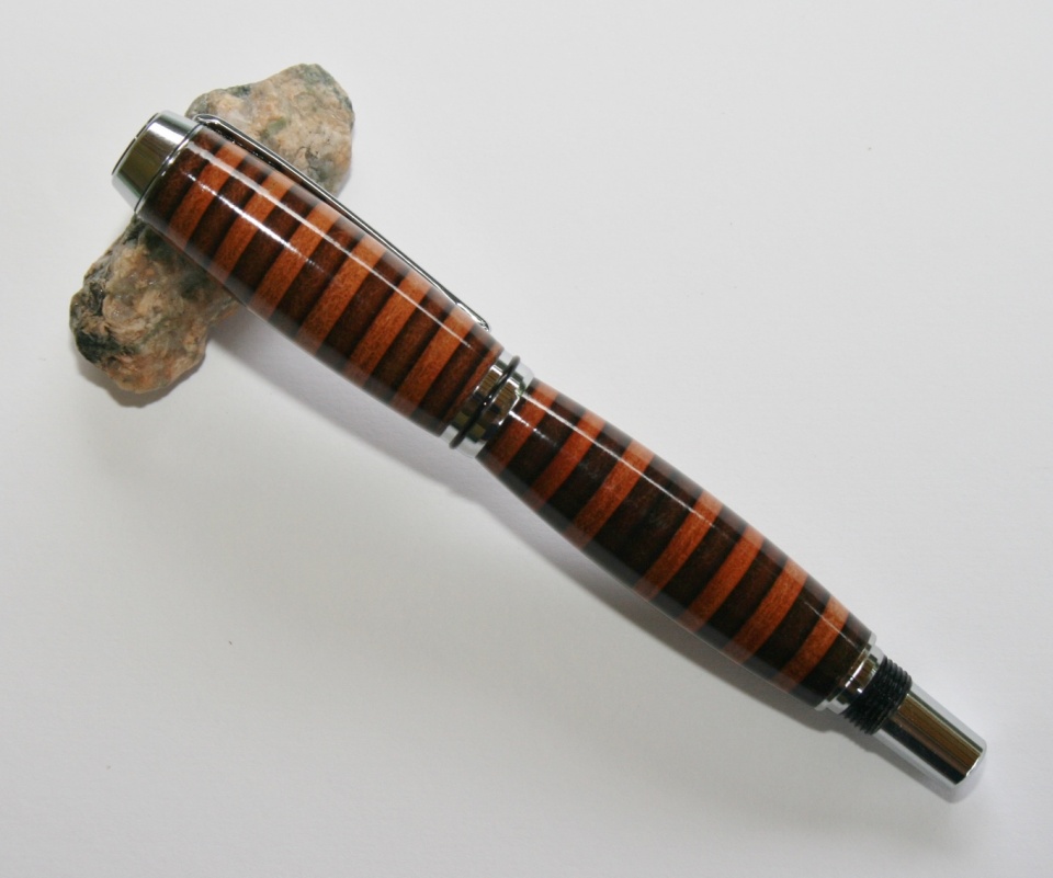

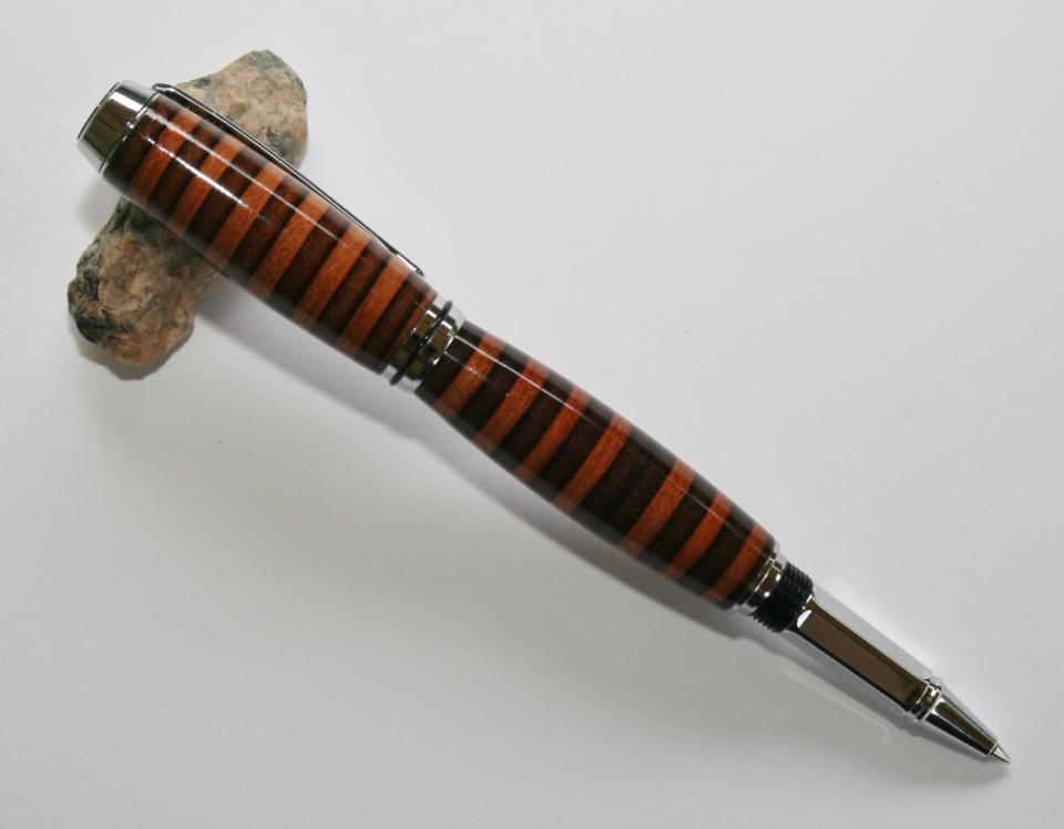

When I do a leather pen I cut the leather pieces to size and punch a hole for the tube/s. I then mixup a solution of about 50/50 mixture elmers glue and water and let the leather soak for at least 24 hours turning the pieces ever few hours. After the soaking I remove the leather pieces from the mixture and let them dry for a few days. I then glue the up on the tube with elmers glue and clamp them and let dry. I don't rush this part and keep tg clamp on for 12 to 24 hours. I then set then aside for a few more days.
Then I use carbibe and sandpaper for the shaping I dont get any softening or gum up. But I do take my time. I finish my leather pens with WTF and I feel I get a good finish.
The way I do a leather pan does take some time but then the outcome is worth it.

Those are AWESOME pens. I made one for a friend that does leatherwork and she loves it. It was a mess, mostly because I didnt exactly know what I was doing, so I was winging it a LOT. Mine did not turn out nearly as even or perfect as yours. I used all CA on it. I guess I need to try some WTF for finishing. I was wondering if there is a finish that can be used that will end up with more of the leather feel when complete if you know what I mean. I know she loves the look, but thinking she might really appreciate feeling the leather itself, but not sure how to do that and have it stand up to use. hmmm

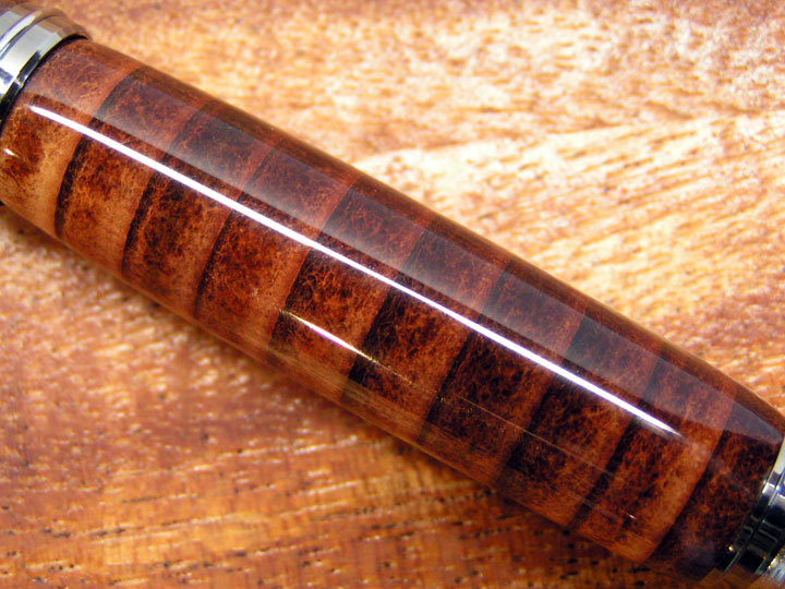

I have an old bottle of hide glue that I use to glue the pieces together. Once dry the glue seems to offer some support also. I do finish it with CA and it doesn't seem to take much to get a glossy finish.
