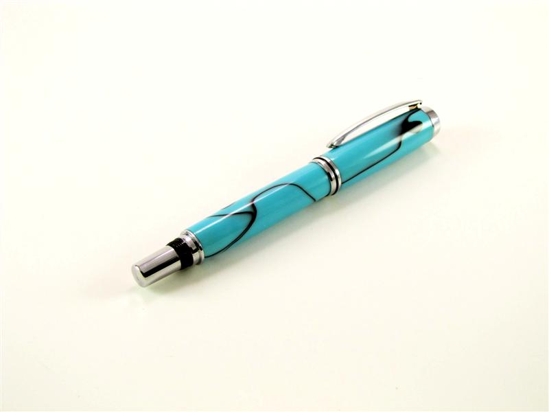

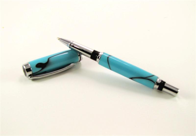

Hi All,
Spent some time in the shop today and was able to make a pen using a JrGent kit from Smitty's Pen Works.Thanks to Smitty for the quick shipping,as always.
I ran into a problem when I went to trim the larger cap barrel.I did not have a barrel trimming sleeve that matched the diameter of the brass tube.i ended up freehanding it close on a disc sander and then block sanded it to finished size.
My disc sander is not stable,accurate enough to build a jig like I have seen here on the forum/library.
Are there other inserts that I need to purchase?
Thanks,
Andy

Drill a 1/4" hole in a srap piece of hardwood and carefully turn it to the proper size. ... sneak up on it ...
Or, you can purchase sleeves ... I believe the PSI Tycoon kit uses the same drill bits and therefore the same sleeves. You can often purchase them as a package where they throw in the drills and sleeves for free.
btw,... Nice Pen !
