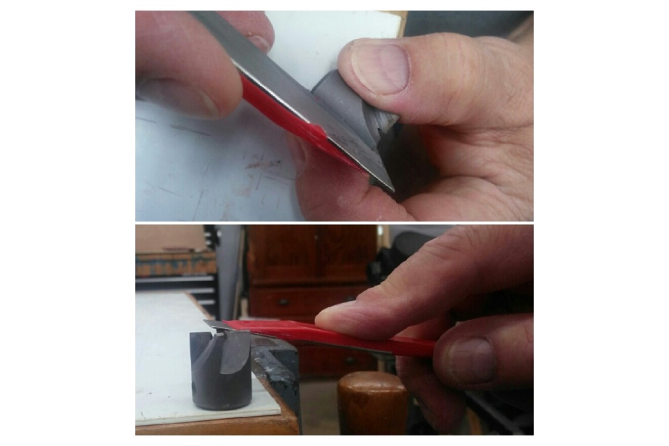

terry q
Jun 2, 2004
736
301 E. Court St. Roanoke, Illinois, USA.
Your mill needs to be SHARP! A new mill is not Sharp. I use those little paddle diamond sharpeners. Specifically the red one. First step is to carefully polish the 4 faces of the mill. Keep it flat! Next I polish the angled edge lightly using small circular motion. I do this every 35-50 blanks depending on how hard the wood is. Composite and stabilized blanks I do this more frequently.

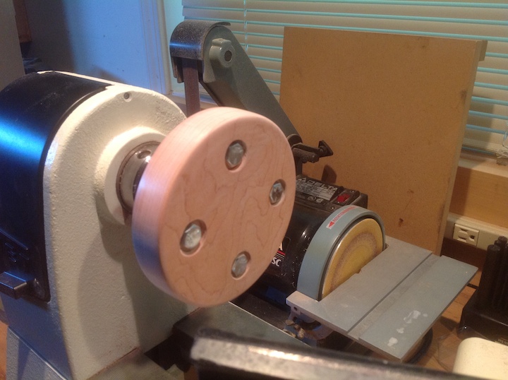

My faceplates faceplate...
Thanks for all of the suggestions! I tried making a faceplate out of MDF, but even when finished, it seemed too 'mushy' for my liking. Additionally, I wondered if I could successfully stick the sandpaper to its surface over and then remove it and over again. Might just be the scrap MDF I had.
So, last night I found a piece of maple scrap and made the faceplate. I secured it with 1/4 28 bolts, lock washers and nuts that are counter sunk into the plate so I don't rip my knuckles or other body parts off while it is turning.
I don't have a blank to trim right now, but as soon as I do, I will let you know how it works. But for now, it was fun to make and turn to a round shape, and then sand. Boy, this stuff is fun!
Thanks again for the suggestions. (Also in the picture is my little drum sander. Too small for me to figure out a jig for it.)
Warren
Warren
Looks great warren. The sand paper adhesive will begin to stick to the faceplate so after several pieces I use DNA and remove the adhesive residue. Enjoy :biggrin::biggrin:
