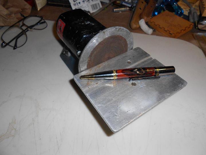

I like to use a disc sander and straight edge. Very simple.
