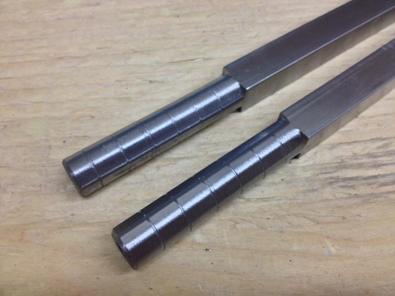

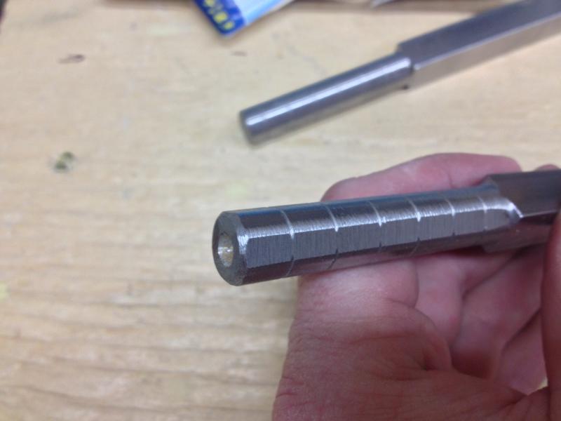

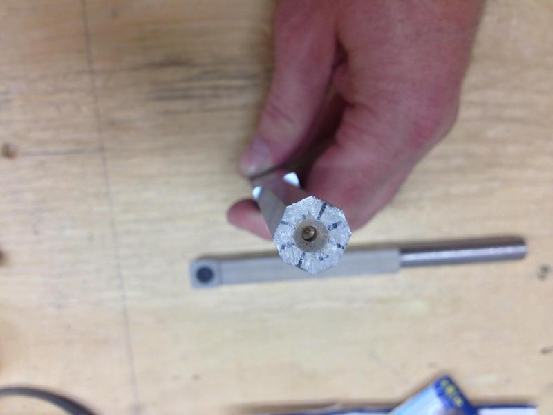

I ground the corners down until the distance across the new flats I had created was between 0.490-0.480". This created an octagon that measured 0.500" across two directions and slightly less across the other two directions. It was also 0.530" across the points of the octagon.

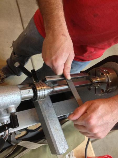

I then mounted the bar in my lathe and used a file to round off the corners until it measured 0.500" across the corners. I also used the corner of the file to cut some grooves to help the epoxy grip it. You can't really tell from the photo but I am standing to the side and am holding the file so that if it grabs it will not hit me and my left hand is only pushing down on it so it won't pull that hand into the spinning piece.
This created a tang with four slightly rounded sides which will fit snugly in a 1/2" hole and four flat sides that are slightly smaller which will provide space for glue.

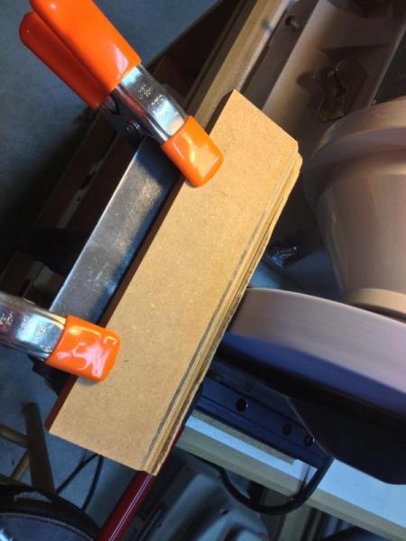

When I first did it I ran into two problems. First, I tried free-handing the grinding and it didn't turn out very even, which isn't a big deal aesthetically because it will be hidden in the handle but it did create more filing. Second I tried to drill the hole in the end for my live center using the lathe but the lathe didn't hole the bar centered enough and so the hole was really off center. I ended up using a cup center to hold it while I filed it and then cut off the part in the cup center.
I made a second one and corrected those two things by making a v-cut jig to hold the bar so the grinding was even and I marked the center, hit it with a center punch and then used the drill press to drill the hole for the live center. Even doing that took two tries because my first center punched hole was just slightly off center and I didn't realize it until I had drill it with the center drill.
Comparison of the two finished tangs. The closer one is the second one and you can see there is less rounded area which meant considerably less filing.
