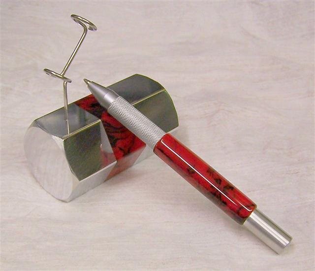

Here's another pic of my Wk4 pen challenge entry. The hardest part to make was bending the stainless welding rod for the spring.
I didn't do the knurling on the grip. My knurler can only do a narrow band, this piece was from a broken pencil. The aluminium nuts are transport caps on stuff my company makes in USA. Getting the anodizing off was a nightmare.
The PR is my first mix:D

Simply amazing. When ever we start to wonder what more can be done in a few inches between a nib and a finial you remind us of the endless possibilities.

Just outstanding! Once again you have managed two think outside of the box.
Very nice looking PR.

Next time you need to remove anodizing use EZOff oven cleaner. Put the parts in a baggie and spray the cleaner in almost immediatley it will start to disolve the anodizing. once all the color is removed wash the parts good in plenty of water to neutralize the acid. Make sure that the ezoff you use is not the no smell kind use the good old smelly stuff. I have used this many times and works like a champ.

Larry, that is a fantastic tip, thanks:D It would have saved me hours of sanding. There were some deep scratches through the anodizing that I had to sand out anyway, but in the main it would have really really helped.[xx(]
I also recieved another cool tip on knurling via e-mail. As soon as I try it out I will thank him online;)
