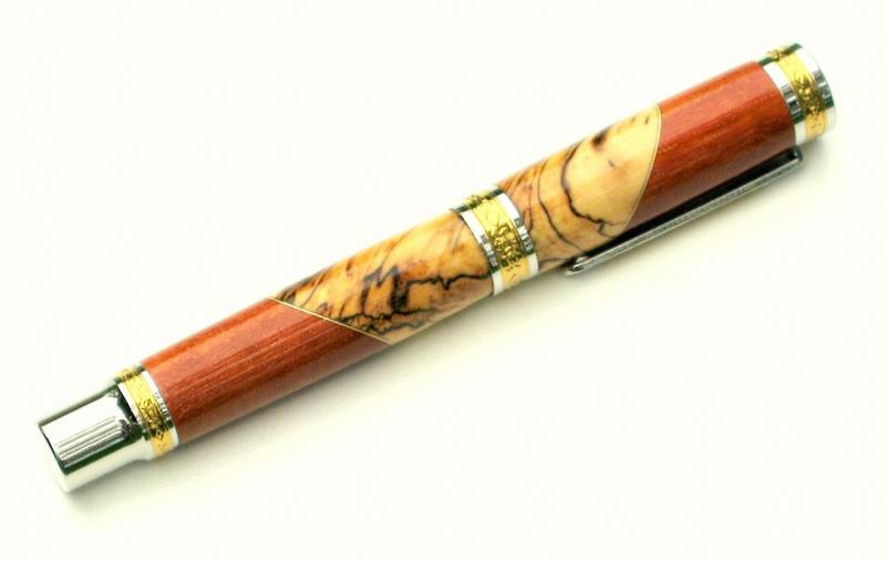

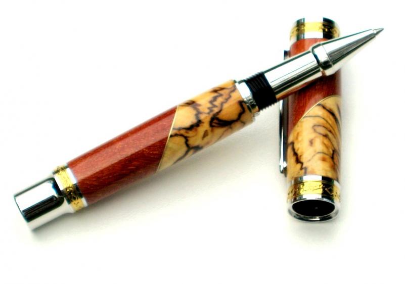

Here is one of my latest pens, Spring Blossom with Cooktown Ironwood, Spalted Northern Tamarind, and Brass, finished with CA.
Comments and critisisms welcome.

Looks good !!! Any more segmenting on it would have been OTT on that kit, but you got it just right I reckon.:good::good::good:

Nicely done. The high degree of spalt really stands out and the brass picks up the gold rings. Great attention to detail. What gauge of brass is that?

Thanks Guys.
I didnt even think about the contests running when I posted the pics.
I would need better photos to really show it at its best, I am just using a little automatic Cannon, and the photos arn't quite in focus.
