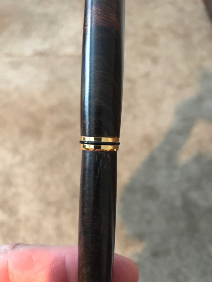

I will post a photo if it helps.
I apologize for not knowing more about the Blackwood - it was labeled diamond cut Blackwood and nothing else - very pretty wood. The photo is of the Blackwood.
The other woods were an Indian Rosewood and a Jack Daniels Oak Barrel stave.
I didn't use anything other what I had mentioned which is what is normally do for a pen before A CA finish - DNA and Mylands sanding sealer.

Yes rosewood is one of the oilest woods and that blackwood is too. Need to wipe down with acetone or lacquer thinner. DNA has too much water. Need to be sure the wipe down is dry as well as the shellac. Use a clean dry cloth and not one of those microfiber cloths. That is a no-no in woodworking. That barrel stave blank definetly needs to be sealed because of the liquor content. Alcohol and lacquer do not mix well. You do not say how many coats you are using. Too many is not good and too little is not either. Spraying technique is important too. read instructions on can.
If all else fails try poly but still undercoat it. :)
