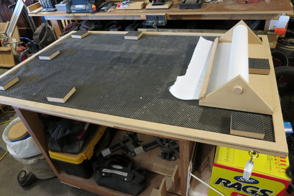

The attached photo show my assembly/sanding table, which by coincidence is the ONLY place I have to set up a lathe. So, I need to be able to set a lathe up and then move it aside when I need the table for something else.

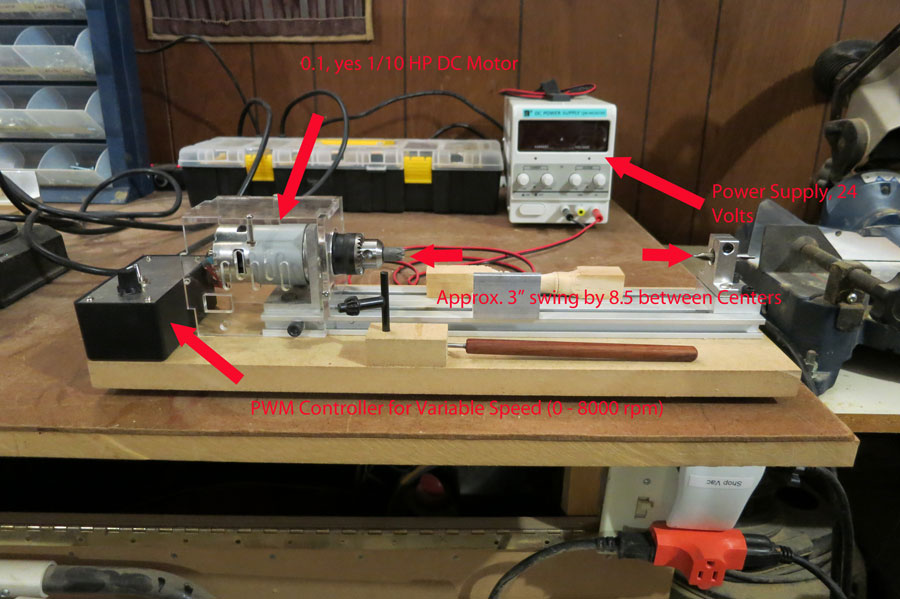

Here's small. I cobbled this together from a Chinese kit just to see if I could turn something. I actually managed some 3/4 x 6 inch stock on it... albeit rather sloooowly. :eek:
All you guys have given me some ideas, and some things to think about. Thanks for being considerate to the "new guy", with what has to be a well-worn subject.

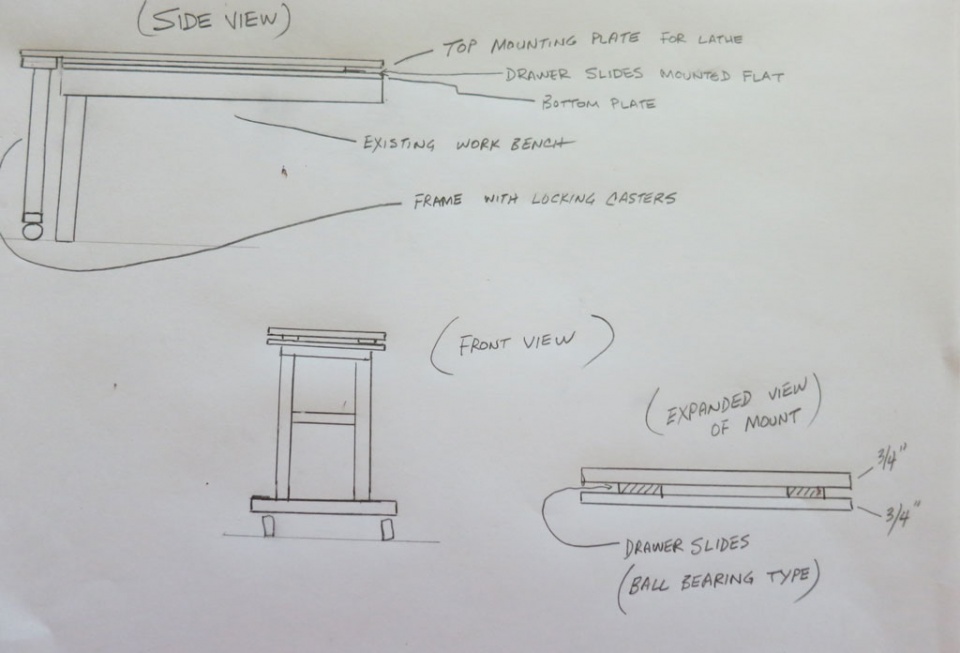

Here's a quick drawing of an idea, based off of my sliding drill press table. For you experienced turners, can you give me drawbacks or design flaws?

Since I've never used a lathe, how "tippy" are they? In other words, if I wanted to build a stand, how wide should it be to give good support and how much lateral stress is there during turning?
Lathe's aren't particularly 'tippy'. I assume that by 'lateral stress' you mean side to side - that's also not a particular problem.
The two problems you have to address with lathes are:
1. Vibration - a lathe is a very smooth machine when the workpiece is round, but roughing a blank to round causes lots of vibration. Obviously, the smaller the lathe, the smaller the pieces you can work on, and therefore the less vibration you have to deal with. Having the lathe bolted to a stand to prevent 'walking', and having something to give that stand weight, will minimize vibration. Many people just have a shelf below the lathe, and stack bags or boxes of sand on the shelf.
2. Catches - you will soon learn what catches are (everybody has them), and they cause a sudden, severe torque on the lathe that tries to tip the lathe toward you (or flip tools upward). Bolting the lathe to its bench is the best way to avoid tipping.
The bench doesn't have to be fancy. Mine has an edge-glued 2x6 pine top sitting on the metal substructure from an old gas grill (with wheels) so that I can easily move it around the shop. I have short lengths of 2x4 that are bolted to the top, and the lathe is then bolted to these 2x4s - that was done to elevate the height of the lathe and provide a bit more space under the machine. (Ideally, the headstock spindle of the lathe should be at elbow height with your arm at your side.)
The width of the bench must be at least enough to allow the feet to sit firmly on the top. Practically, however, you will appreciate additional 'laydown' space. If you are right-handed, having that space on the tailstock end will be more convenient. You will also need depth - the front of the lathe should be no more than a few inches from the front of the bench - you don't want the front edge of the bench limiting your movements with tools. How much space you need behind the lathe is a matter of personal choice - it's main purpose will be to collect shavings. Like many people, I have a tool rack on the back edge of my bench - that's fine but understand that it's dangerous to lean over the lathe to get a tool with the lathe running.
