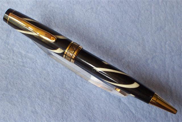

Ed4Copies had the same problem.I haven't had one crack, but I havenever turned one that I didn't add a pattern to.
I drizzle thin Ca in the hole after drilling.
I did make one called "Arbez" that had a white tail inlay spiral design with buffalo horn being the mail body of the pen.
Ed and I came to the conclusion the inlays may have stopped any "movment" and cracking.
Arbez
