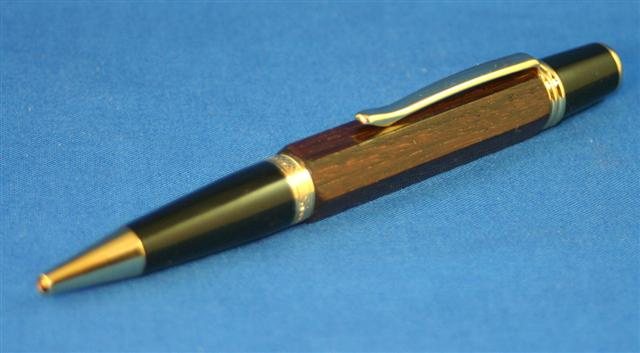

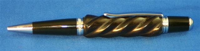

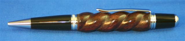

I had some shop time today and made these three. I'm doing a demo Sat and thought I had better practice. First pen is African Blackwood and the spiral is one revolution in 2". The second is E. Indian Rosewood and the pitch is one revolution in 1". This is the better spiral because of the width of the rope twist router bit. I had forgotten which pitch to use. The first pen will be redone like the second one. The third pen is also E. Indian Rosewood with 6 flat sides. Making them isn't so bad but sanding them is ......not fun. As always, comments welcome...good, bad, or indifferent.

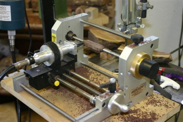

I use a small stand alone mill called the MillLathe whick is now out of production. It was originally sold by Woodcraft. I snagged mine off of ebay a couple of years ago. I've attached a picture of it.

Thanks Johnny. I'll take your advice and leave it be. Will you be coming to bubbasville and the Tex. Penturner's meeting Sat. If so, you can see it done and we can even make you one.
Randy,
It doesn't feel any different that a standard sierra. The spiral ones are a bit big/fat but they don't feel awkard either.

I like them all, I need to try the flat 6 sided shape on my Legacy200, will need to buy a different bit as all I have is barley twist and rope twist bits.
Don can you show me a picture of the bit/cutter you used for the flat sided pen, so I buy the right thing.

Beautiful pens I like all but since this is the first 6 sided pen I see that is the one that grabbed my attention the most

Very nice Virgil, I like the flat. You cheated on the spiral's, what happened to cuts 2 & 3 ?
Do you charge extra for hand sanding?

I'm not sure what happened on the top pen. But, you meant cuts 2 & 3 on the second one? Does the "pitch" effect the looks of the rope spiral or did I do something wrong? On the E. Indian pen I indexed 180 degrees and just made two cuts. On the blackwood pen, I indexed 90 degrees and made 4 cuts. I'm going to try to figure it out today.
Sanding is a LOT extra. That's the hardest part of doing thise, as you've mentioned before.

I miss understood your original post, I thought you made only 1 cut or pass.
I thought the formula was 3 passes with a 1/2 cutter. But I guess that would change if the pitch was changed. What do I know, they still look great. [:)]

The small Legacy had a 1.5" pitch, so 3 passes are needed. The mill lathe allows 1" and 2" pitches, but not 1.5" with the provided pulleys.
