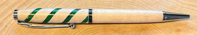

I'm continuing to play with inlaid polymer clay. Here's today's result.
Body is Butternut
ACM Centerband
Green Polymer Clay
spiral with Black Acrylic paint
Thanks for looking

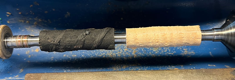

A little more detail...

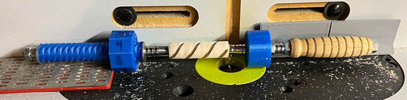

The spiral trench was cut using a cutting jig I 3d printed.
Cut strips of green polymer clay, dunked them in black acrylic paint and twisted into spirals before packing the spiral trench.
(I'd give myself a B+ on this... I'm still looking to improve the end result by making a more interesting black and green pattern.)
Baked at 250 for 30 minutes.
Turning this is fun! The green pops out and polishes very nicely.
