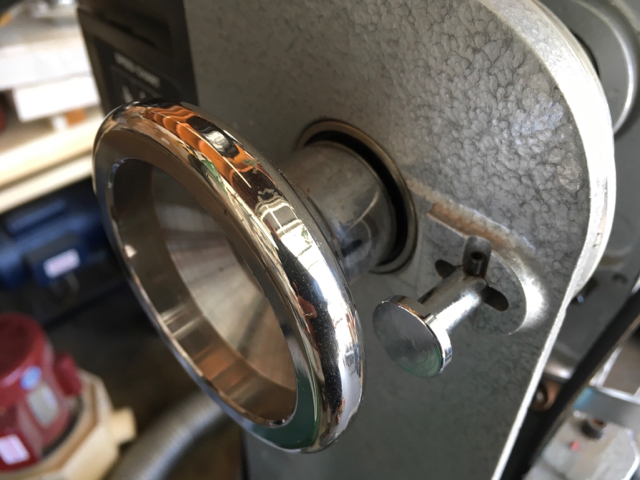

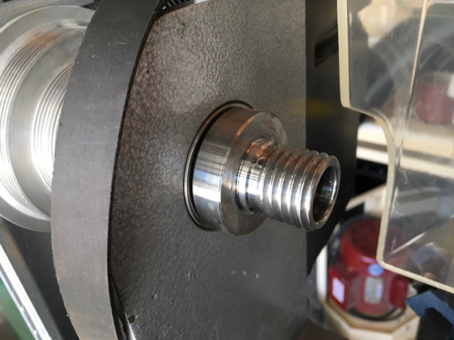

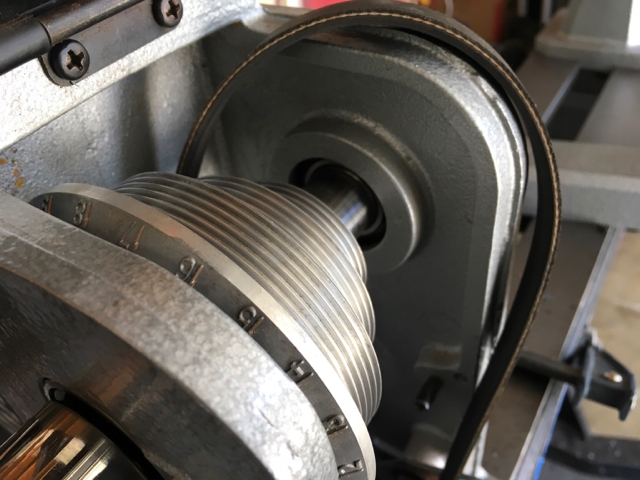

My lathe is about 7 years old but it has sat for the past 5 years doing nothing. I just started turning again and I bought a mandrel saver. I've noticed after only turning 3 pens that my spindle handle gets really hot while I'm turning and so does my motor now. I don't recall this being the case before. I have a delta midi lathe. There was a service announcement about the spindle being too tight from the factory so I did the fix and loosened it about 1/8 of a turn and things still run hot whether I'm turning something or not. Any suggestions? Does this mean I need to replace bearings? If I do how would I know? I don't want to burn out the motor that's for sure. The belt looks fine. Things are lined up.
Thanks for the help.

You may need to loosen the bearings more. On metal lathes this is call "preload" and is usually set by temperature. Run the lathe at its highest rated speed under no load, and check the temp after 15 minutes. If the spindle nose is hot, back the preload off more. You should be able to touch and hold the spindle nose. It will be warm, but not hot to the touch. The spindle nose should not have any free play in it.
Another possibility is the grease in the bearings has thickened and the bearings are heating from the friction. This may be caused by the hot temp. On some lathes you can add some solvent to free the bearings up or clean and replace the grease or oil used in the bearings.
Lastly, check the pulleys and make sure the set screws that hold the pulleys are not loose.

When I remove the belt and just hand turn the spindle it seems to spin freely and fine. No bumps. No stethoscope but I tried the screwdriver thing and heard nothing either.

How would I use a solvent to clean these? If the lubricant has gotten too thick that may be some of the problem?
I checked the set screws on the spindle wheel and it's tight - from factory.
The set screws on the spindle handle is also tight.

By hot do you mean, you can or can't hold your hand on it? The bearing is surely a sealed, permanently lubricated type. If it is so hot you cant keep your hand on it for any length of time it will need to be replaced.

I wouldn't say it gets so hot I can't touch it but the motor and the spindle handle and the area around the bearings gets hot enough that I wouldn't want to leave my hand on it for more than a few seconds.
I ordered bearings today just in case. I have a feeling that is really the only thing I can try besides loosening the spindle handle off the bearings on that side which I already did.
