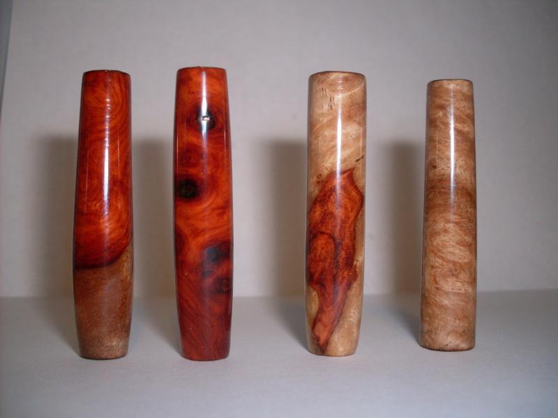

Thanks for all the great info. I went into the shop this afternoon with the mindset of working on finishes. The first thing I tried to do was fix the PH from the night before. I realized the scars were deep in the finish. So, I tested out my home made round nosed scraper and turned the pen down to brass :smile-big:
Next I grabbed a Burl blank that i got from a grab bag. Turned to shape, then finished only with thick CA. Temp in the low 60s and raining. I don't know why I haven't tried a finish with thick CA. I figured out my problem before with the thin CA is that I was rushing to get it on the pen before it all soaked into my paper towel. Lesson Learned. Thick and medium CA for finishes and Thin CA to stabilize blanks.
Then i turned a one piece pencil from PH. Sanded to 600. Then I put a nail in a small clap, set it in the window, and put the pencil on the nail. Will finish it later once it turns purple again :)
Then I grabbed another set of blanks and repeated what i did with the Burl. Success. And I only spent 2 hours doing everything.:cool:
I did not finish the pens, only made the barrels. I have a few people at work that are wanting to buy pens, I will let them choose from the barrels before I make the pens. This way I can customize the pen with an iPod tip if they want in chrome or let them choose from Gold or Gun Metal finishes.
