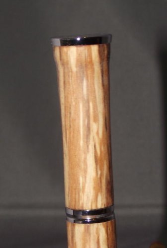

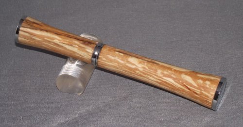

Wanted to try this kit. Fancied a beeswax finish on a pale wood.

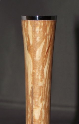

Yep. That's an overcut on the lid. Duh. So I reworked it.
Yep. That's a severely mis-shapen undercut on the lid. I can take more wood off, but I can't put it back on.

Very nice piece of alder . Take the cap apart , take off a bit more wood , cast a layer of PR over top , re-turn (a bit more carefully) , remove beeswax from pen body , cover everything with CA , sand until smooth then back down to 400 grit lengthwise , and none of us will know that you took a circuitous route to your intended destination .

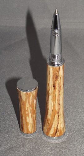

One of the nice things about this kit that I've discovered vicariously is that if a person has problems with grip strength in writing hand, the weight of the wider ends allows enough extra weight to keep the nib in contact with the paper without needing firmer grip.
Also, the CSUSA kit rollerball end can be replaced with the fountain pen nib end from Jr Gent.
I personally love your choice of the beeswax on this Alder wood.

Looks like the beeswax gave that grain a helping hand....well thought of on that lighter colored timber. Do you have a link for that kit?
