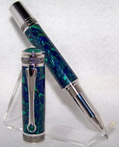

Hint: It is HARD stuff !!
Great when finished though
I am not in a hurry to do another one, even though I have some more blanks. :rolleyes:
Rod

Rod, thanks for sharing with me. That does look pretty cool! Thanks!

You shouldn't have any issues. Keep the heat down and don't be aggressive with the carbide tool and you'll be fine. Malachite is an easy one. This is the azurite trustone with banded malachite accents so its a stable blank. Let us know how it goes!
