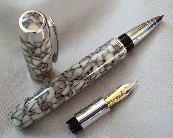

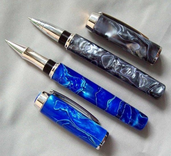

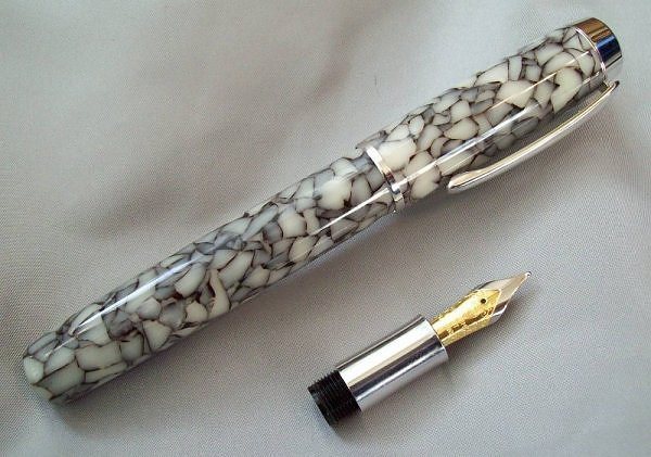

I have a customer who requested a fountain pen that he could change over to a Rollerball whenever he chooses. I contacted CSUSA to see if I could get just the rollerball finger grip & spring. Nope, I needed to buy an additional kit for $18.00. Luckily I have a friend with a metal lathe who was able to make this finger grip for me. I wanted a different design to seperate it from CSUSA, and I wanted to make it so the grip doesn't require a spring in the bottom of the pen to push up the rollerball refill. (too much of a hassle for the buyer to remove the spring everytime he switches over) This design utilizes a small spring at the tip end of the refill instead of the bottom. I am looking at mass producing if there is enough interest. Comments welcomed, good, bad, or otherwise.

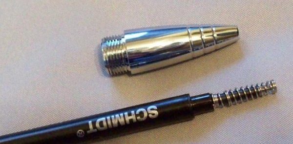

It's beautiful, Joe, and a great idea. I have a couple of closed end Baron's that I switch back and forth, but always with the spring issue. How does the spring work in the nib end? Since the stock design uses the spring to push the refill toward the nib end, I don't understand how a spring in the nib end can do the same thing.
igran7
Feb 9, 2006
1,066
Clackamas, Oregon, USA.
Grant, here is a picture of the rollerball nib & refill with the spring on top as opposed to spring on bottom like most kits. Also this is a picture of the New rollerball nib in comparison to CSUSA rollerball nib.

The metal used on the one pictured is Chrome, weight wise it is a little lighter than the original CSUSA nib (a few grams) I'm not sure of the cost yet, I just wanted to gauge interest. I have 4 of them at the moment. He is willing to make more, but the order will have to be at least 50 to make it worth his while. Cost will be under $10.00 probably closer to $7.00.

The pens are gorgeous, not sure that I like the shape of the roller nib though. Looks like an effortless change over for the customer, which is a great idea.

Joe---It's a great idea, and I would be interested in some too, but I do have some reservations about the shape of the nib. I guess I would prefer something more like the original shape for the Gent, with a concave portion for the grip, followed by a straight taper, or something more like the Jr. Statesman, with a straight segment, bead, then straight taper to the point. I would prefer either of those to the gradual curve of the present shape, which to me looks kind of bulky. It's just personal preference though.
Since you want to make a bunch of these, and offer them for sale as well, you might try an alternate shape and see what the rest of us think in comparison to this one. If this shape is necessary in order for there to be room for the spring, then that is a different matter. I hope that clarifies my comment.
