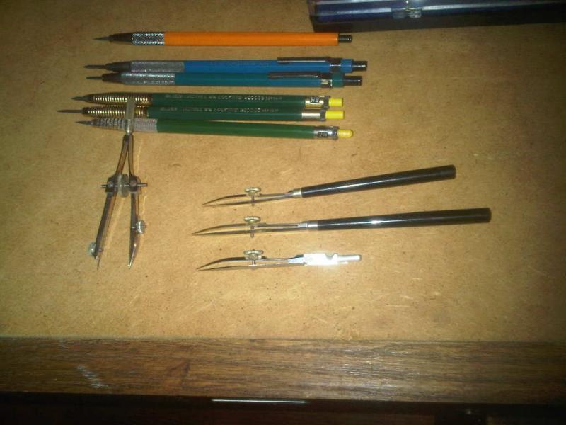

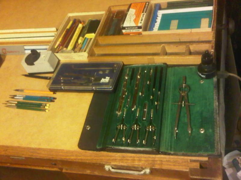

I recently acquired a fairly nice vintage Hamilton drafting table with a few nifty accessories. The mayline rule and vemco 4100 I'm pretty familiar with, and the usual assortment of templates, angles and such are pretty standard toys, but I found some interesting new toys, and thought I'd ask you guys if you know anything about these. They are called spring blade ruling pens and If I recall correctly you don't exactly dip them in the ink, but use a dropper to put a drop of india ink between the blades, then use them to draw a very specific width line.
Any draftspersons out there that remember these and care to share some tips and tricks?
Here's a couple of pics.

I had a little experience with them decorating mats for picture framing. You have the basic concept, use a dropper to transfer ink to the gap formed by the two blades. The main thing to avoid is getting any ink on the ruler used to guide them. It will take a little trial and error to figure out exactly where the line will begin and end. Also handle gingerly, you don't want to shake the ink out from between the blades where it is held in place by it's own surface tension and capillary action.

Dan has pretty well covered it. Do not allow the blade to contact the ruler at the tip or the ink will produce a really cool ink blot under the ruler at the worst time, eg. your last piece of paper, the very last line of your drawing, etc. Also do not try to load too much ink in the pen or it will fall out on the paper. Please DAMHIKT. You get the jest of the rest of the rules for this device. They are/can be fun to work with or can be a real pain. My experiences were some 50 years back in college.
