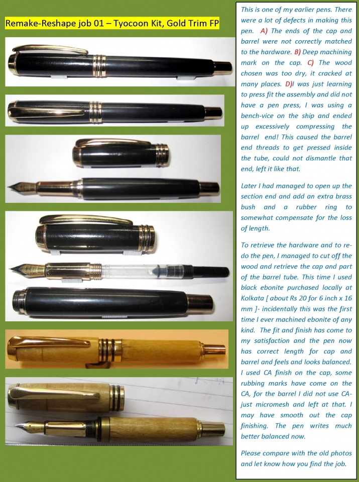

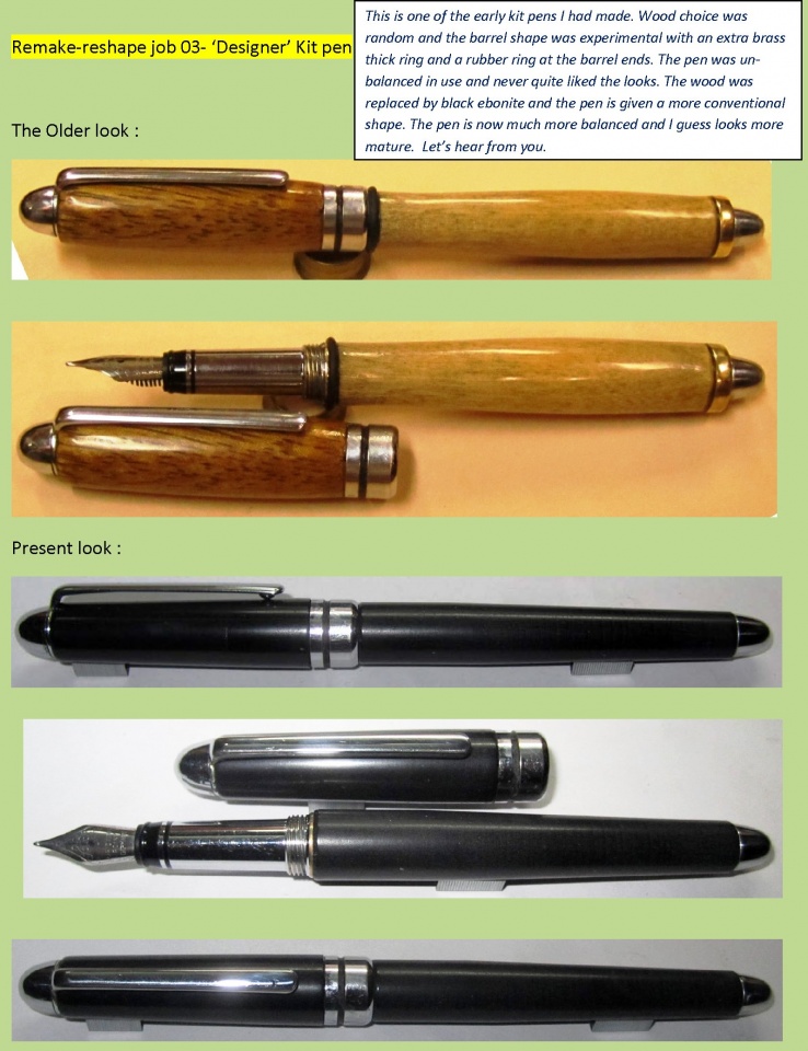

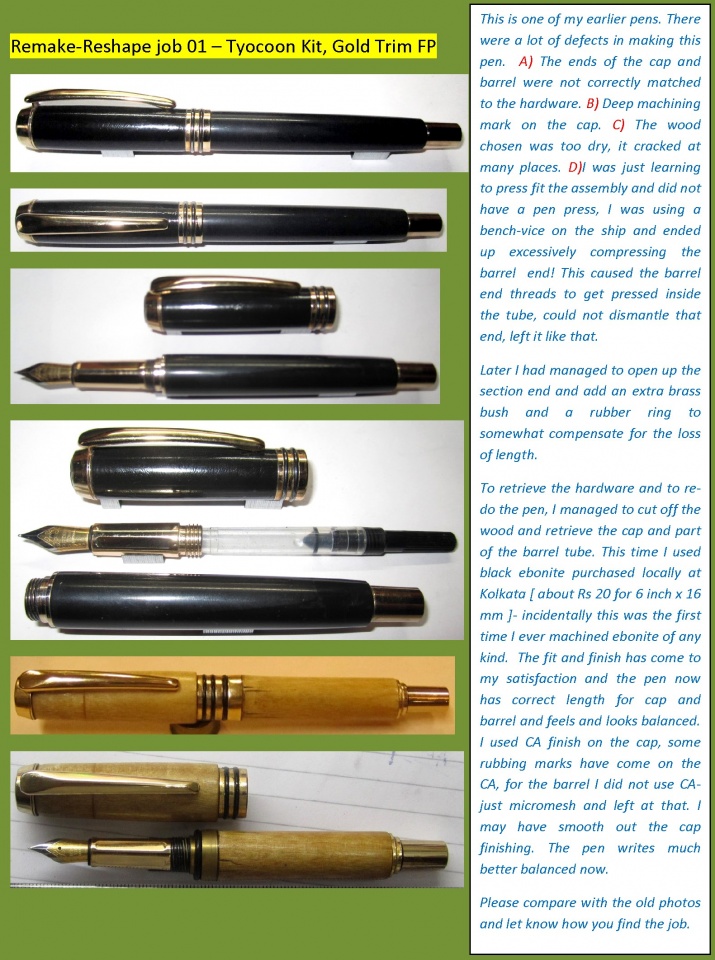

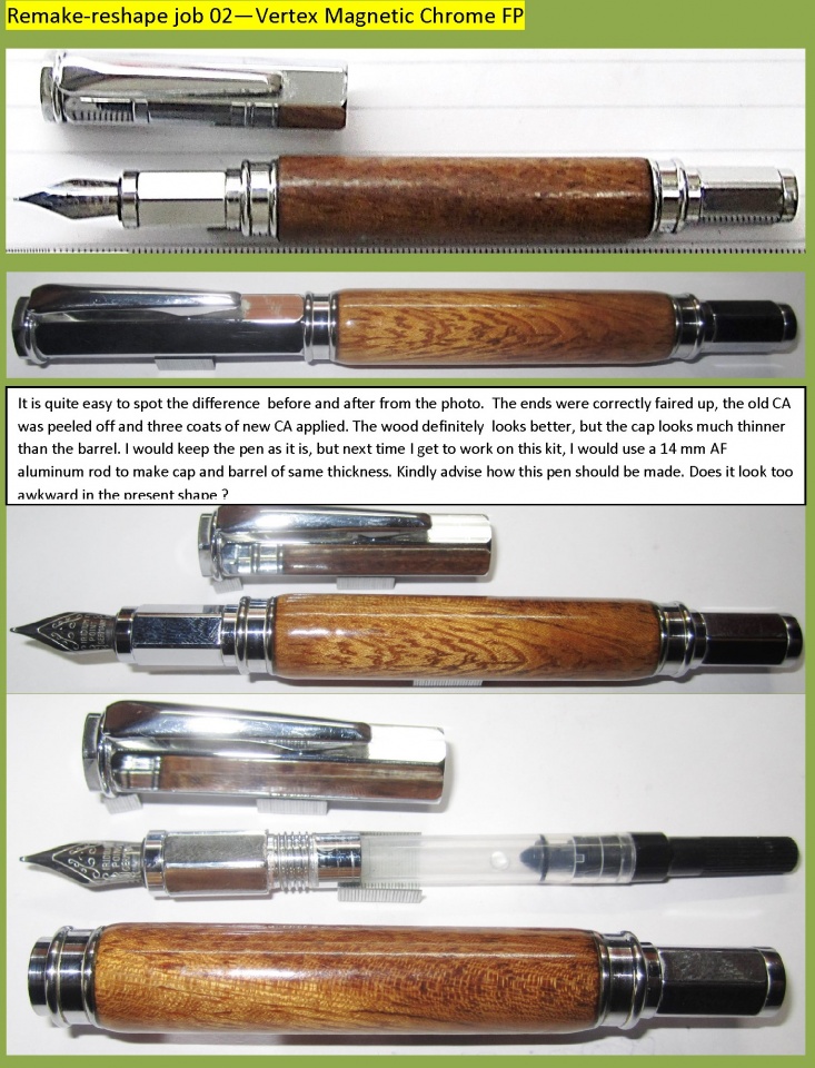

Some recent remake jobs, amature level. Hope you like.

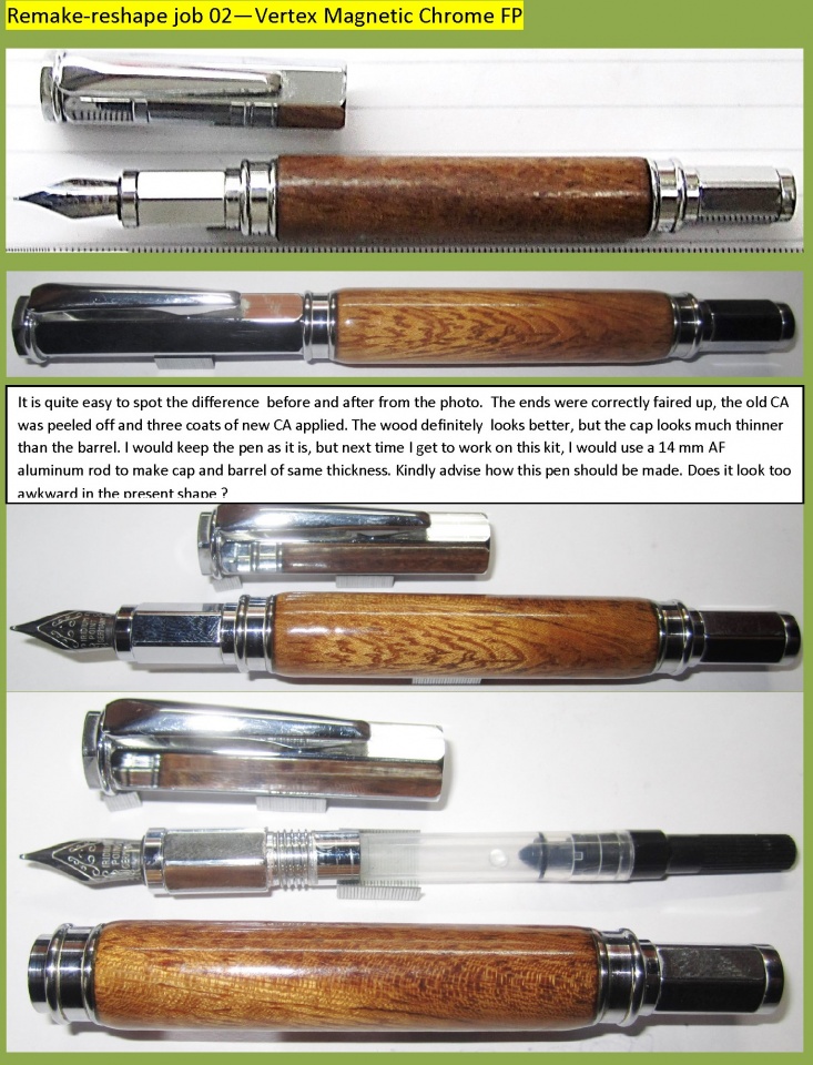

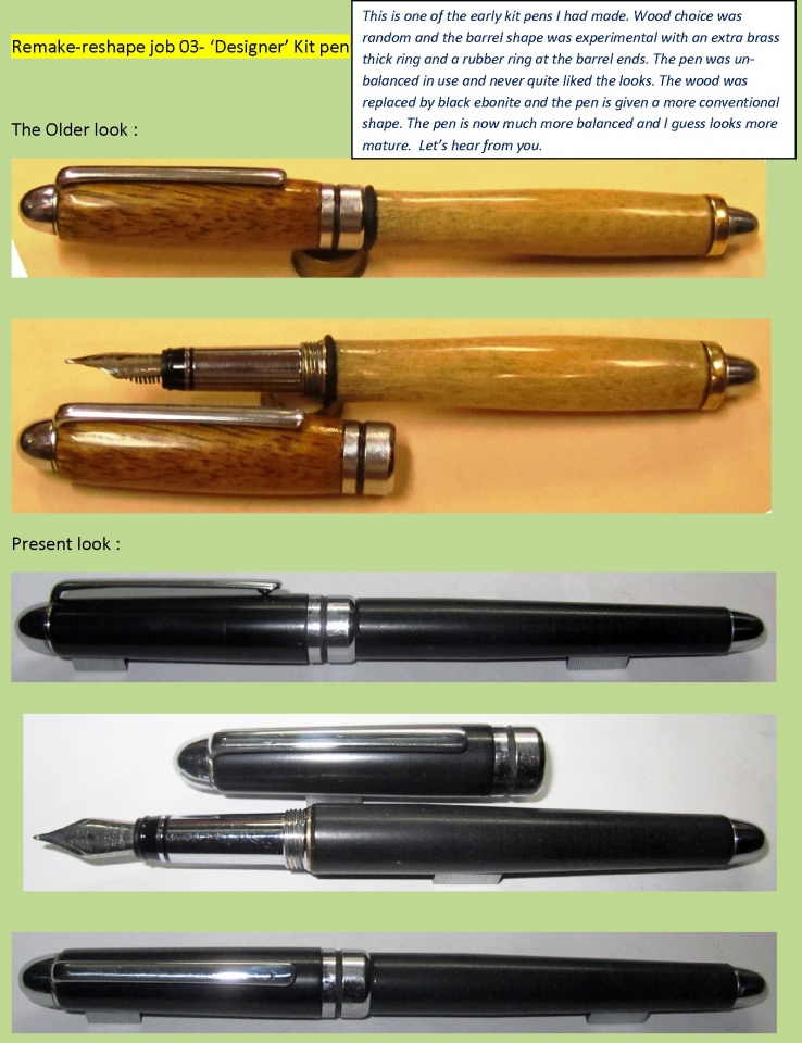

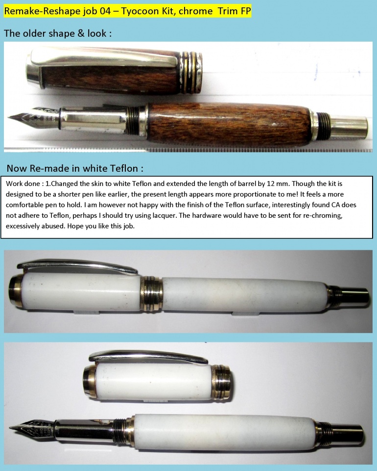

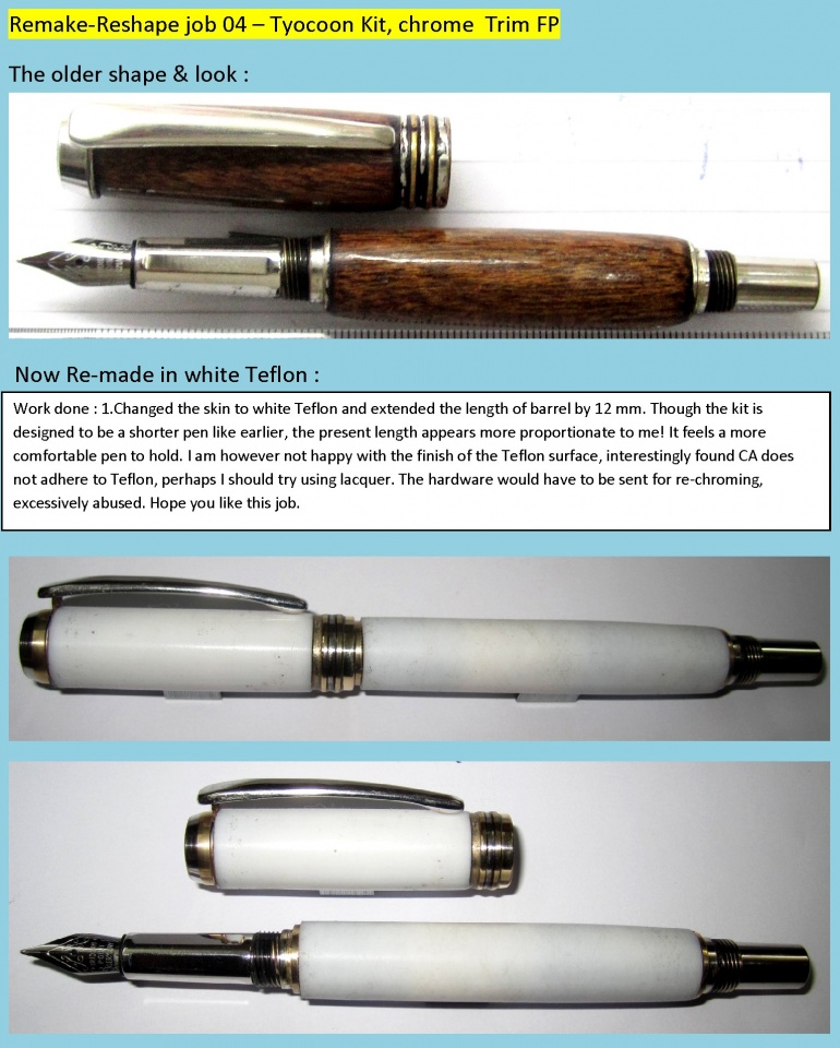

Remake- reshape job 04
Hope you like the change. Please let me know your comments. Also please some one advise me how to properly finish Teflon.

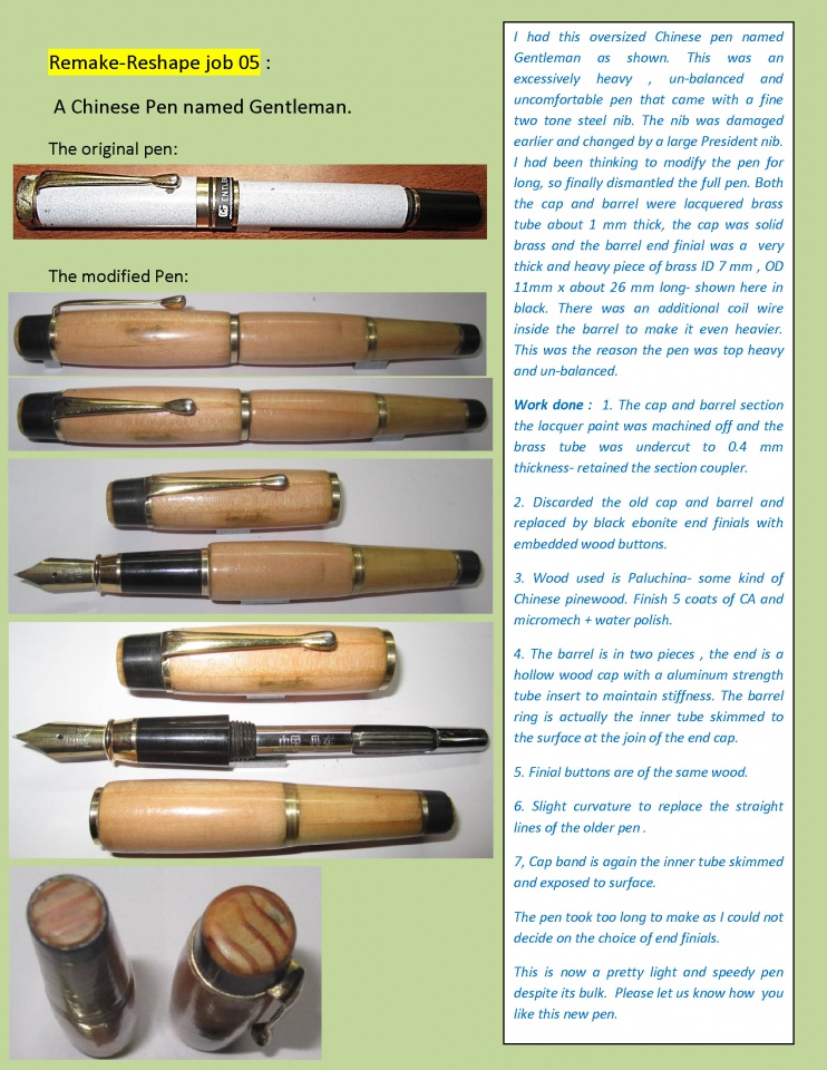

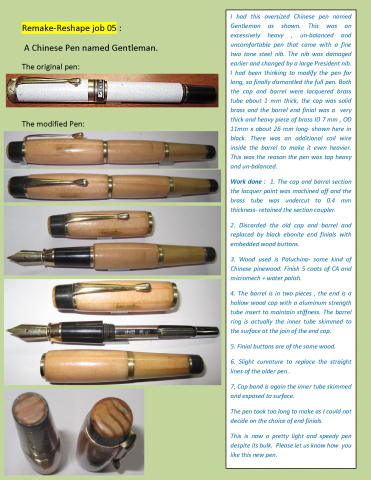

Remake-Reshape job 05 :A Chinese Pen named Gentleman.
I did this remake today- technically not perfect everywhere but I am feeling too happy to show this change! Kindly let us have your views.

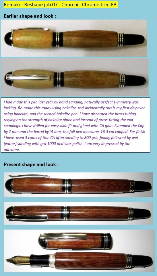

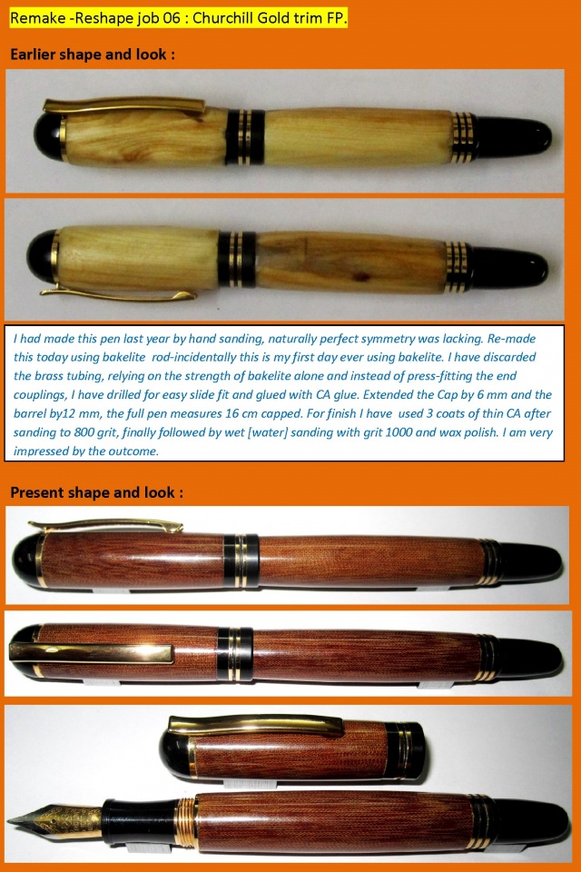

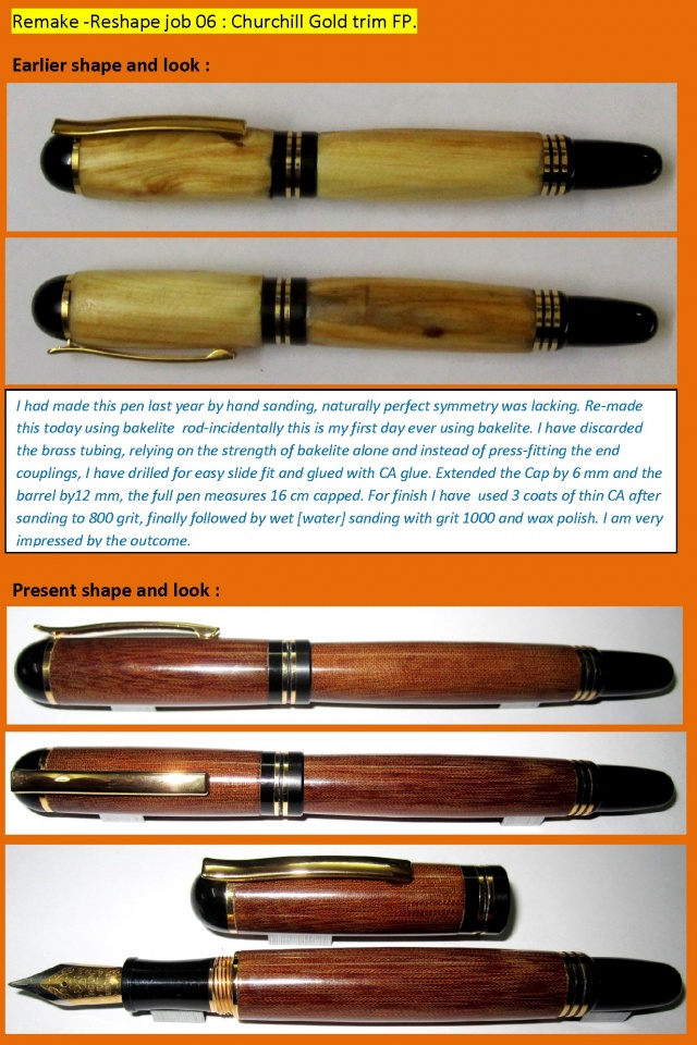

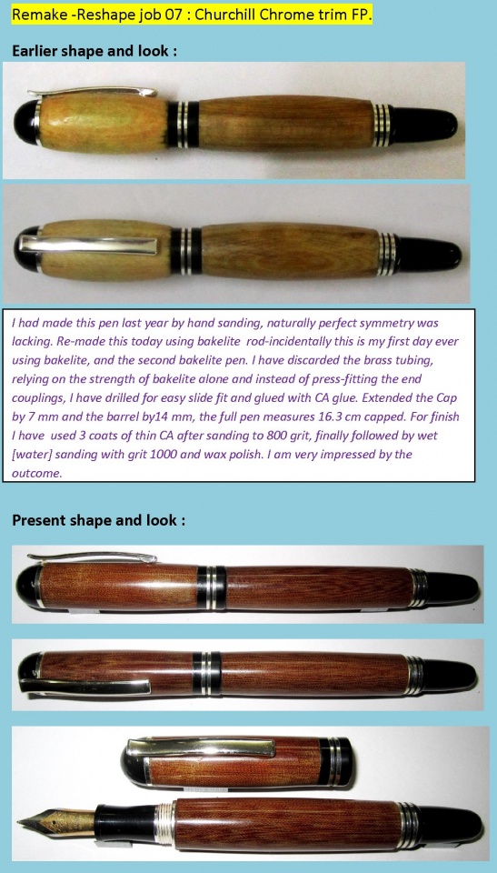

Remake-Reshape jobs 06 and 07
Re-made two Churchill pens today. Used bakelite to replace the wood. This is my first time to use bakelite. I had many of this drab looking industrial bakelite rod lying with me, never tried them earlier as I was quite not sure of the result. After todays experiment I am very impressed with the material- excellent machinability if you go a bit slow and excellent strength, I have even not used the brass tubing.
Like to hear your comments.
