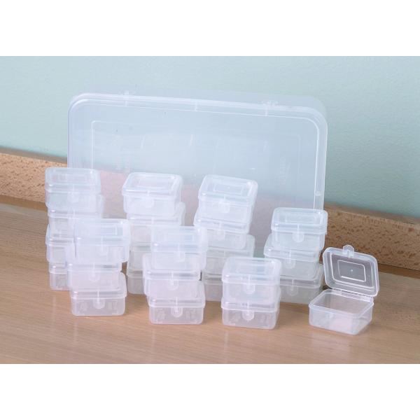

As far as bushing storage, I personally LOVE these containers from Harbor Freight.
They have 24 individual little boxes inside the main box. I use a permanent black marker and label each box with the lit name and model number in case something rubs off.
Here's the link. They run $5.
24 Container Storage Box

OK, great! That's the info I was looking for. I didn't even think of a dead center!
Love the little boxes, and can't beat that price. I've been worried about the little baggies, these boxes will hold up much better.
Thanks again!
