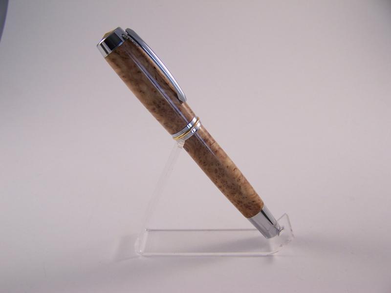

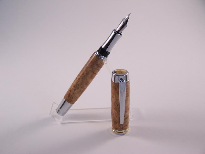

first is a sn gent with eucalyptus burl. 5 coats thin, 12 coats med. I couldnt be more happy with it!

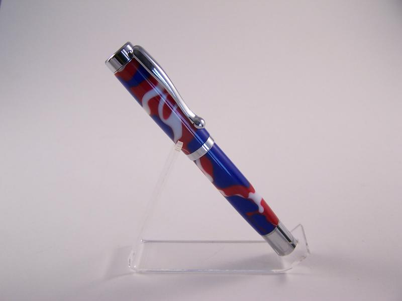

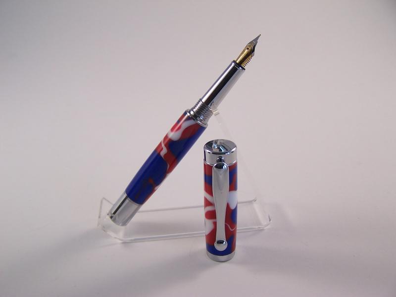

2nd is a red white blue chrome atrax. I am going to make this my new most common pen i make.

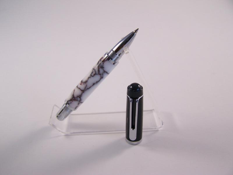

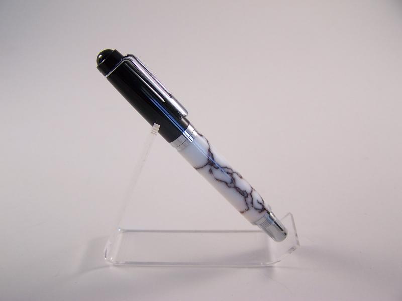

3rd is wild jasper trustone chicago rollerball. This pen is tiny! If you want a purse pen without the purse pen look. then this is what you want. they say u should use a 13/32 drill bit. But i drilled it with a 27/64 and put 3 coats of paint in it. and glued it in. I turned it between centers without bushings. The threads on this pen are excellent. So you dont have to worry about that like on the other craftsupplies apprentice kits. And this is a pen that you practically have to post to write with, because it is so small.

these pens are very nicely done. The Chicago kit sadly uses a shorter refill but I have a question. Can you make your own cap body? All I've seen are black. The twist version sounds like it uses a standard cross refill. Can you share your experience on these kits
crabcreekind
Feb 16, 2011
1,412
Eugene, Oregon
i have not tried to mess with the cap. But i am assuming if you wanted to you could make your own cap, and thread it yourself. I don't like a short rollerball refill, but its not like it is impossible to find.

Glad to see a Sr Gent. I have a couple I'm going to try some day. Guess they're just the Gentlemen's but a little bit smaller tubes. Beautiful job with it. You should be happy.
I'm intrigued with the Chicago rollerball. I haven't even noticed it in the CS catalog. I have to say I like it a lot.
crabcreekind
Feb 16, 2011
1,412
Eugene, Oregon
They are exactly like a gentlemen's pen kit. I used the gent bushings from johnny cnc and they worked fine.
