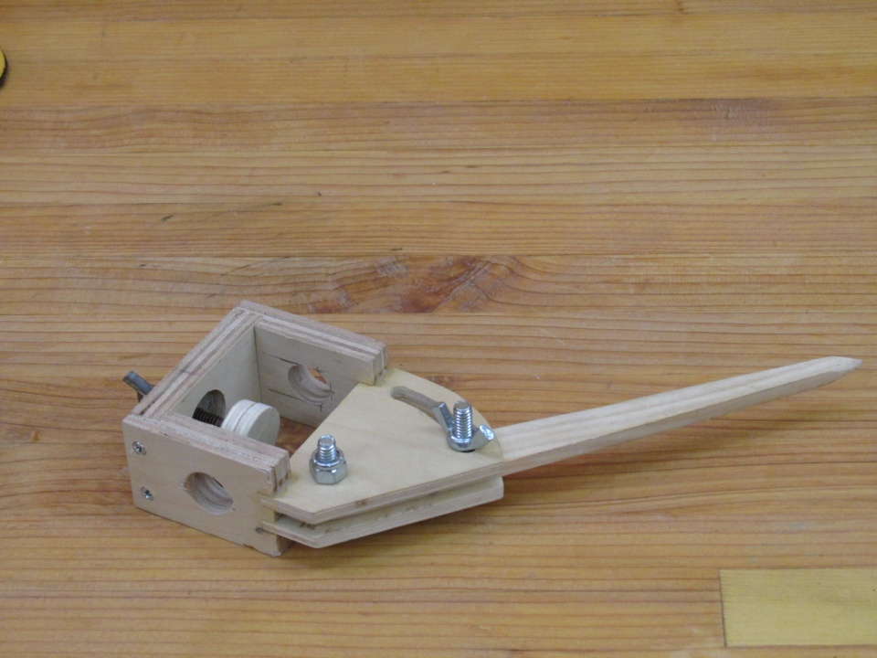

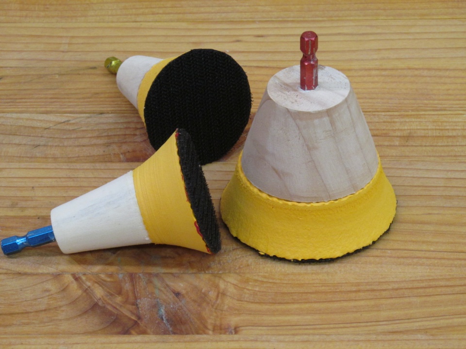

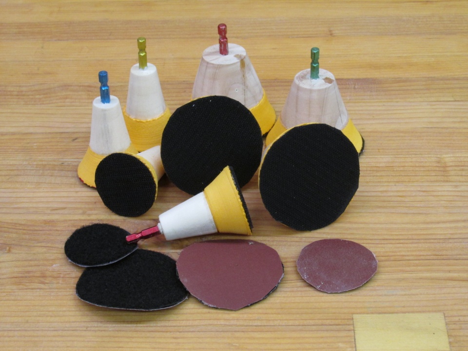

So this summer Doug (Alankulwicki7) came to Faith for a little visit. While he was here we talked about bowl turning. I showed Doug a bowl I had turned and he looked it over. He asked me how I was sanding them. (That bad huh?:redface:) I told him I was hand sanding. He said I should look into power sanding that I wouldn't regret it. So I took his advice, but me being me (I'm sure Wayne, Bob, and Doug won't be surprised by this) I made a set. I found a good write up here and followed it pretty closely. Here are my results.

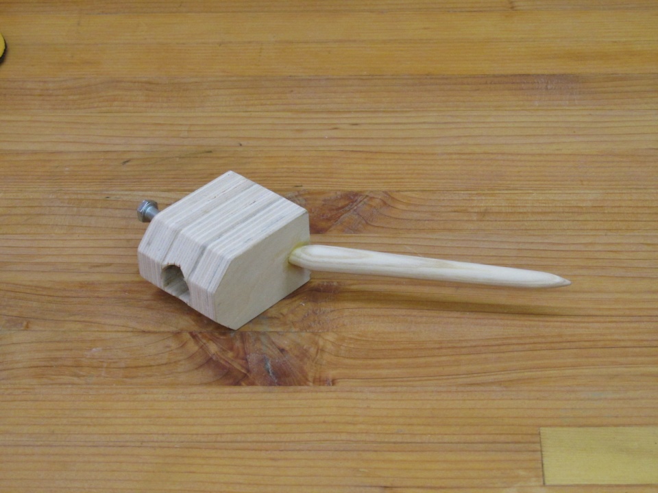

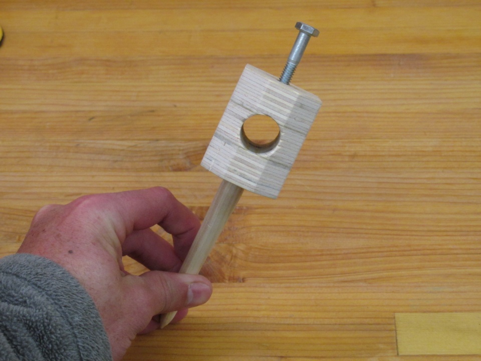

While I was making these I decided to go ahead and make an adjustable jig for sharpening my bowl gouges. I had seen this on a youtube video and printed the plans and had them around the shop for quite a while.
Here is a link to the video and if you look in the description of the video you will find a link to the plans themselves.

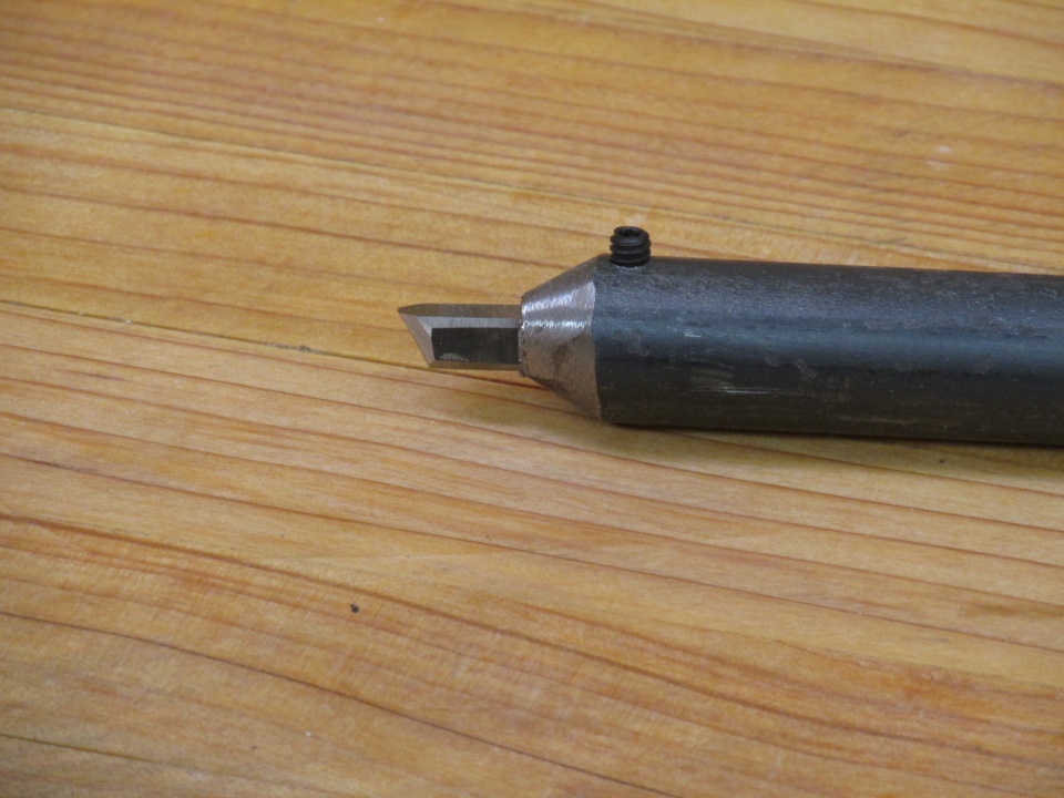

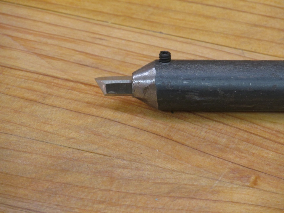

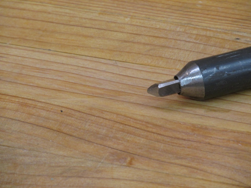

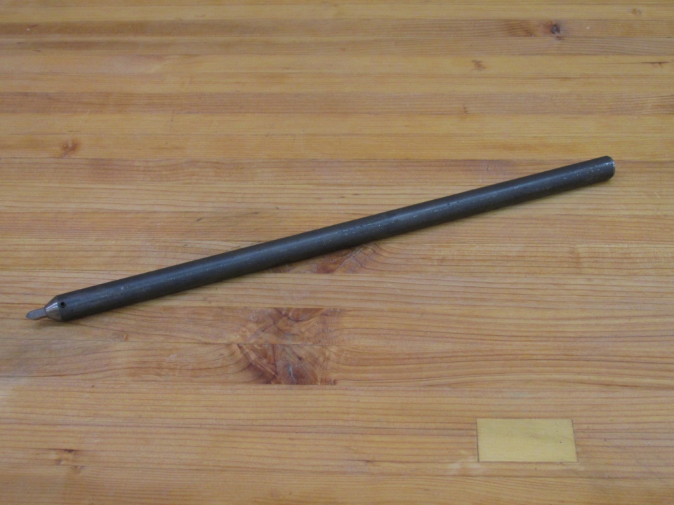

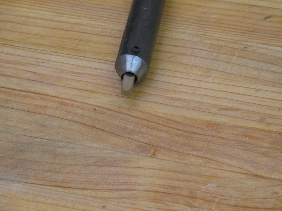

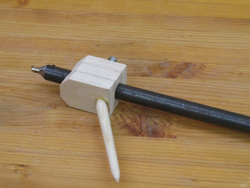

And lastly I made a jig for sharpening my Olund tool. William (Triw51) made the tool for me.

If you don't already own a "close quarters drill" (the kind with a 90 degree angle head) I can recommend it -- much easier to maintain control than using a regular drill when both the lathe and the drill are running.
I got this one from HF. They have a cheaper one that requires a key to operate the chuck -- save $10 or thereabouts going that way. (I'd be tempted to put a quick-change driver bit holder in the drill, no need to take that out of the chuck.)

Another thing to use to hold the sanding pads is a 90* air grinder. You don't have to run it. Just use the handle to hold the pads and let it free spin. Harbor Freight has them for $15.00 at times.
Very nice work there Derek. Do you have the plans for those sanding jigs?
