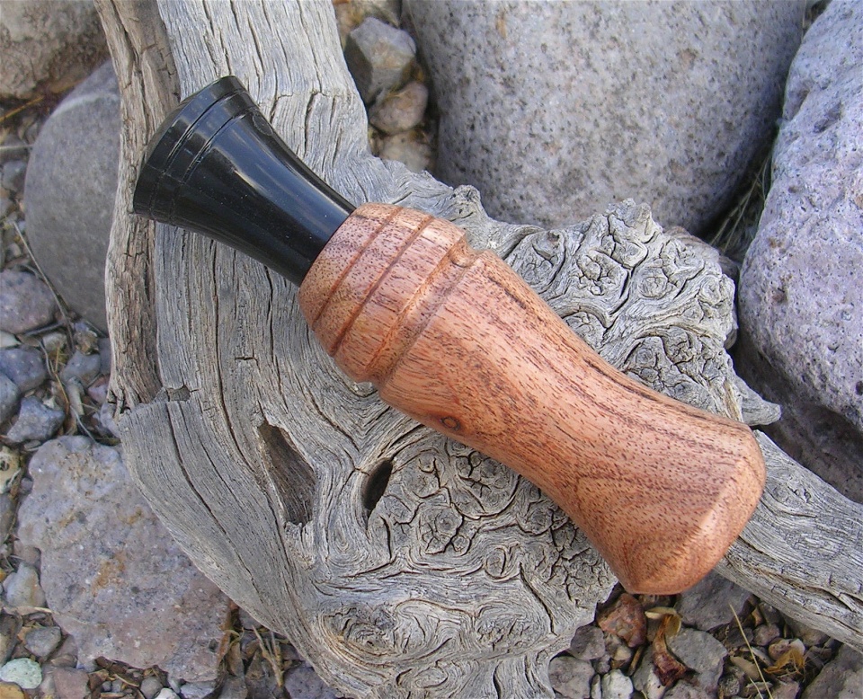

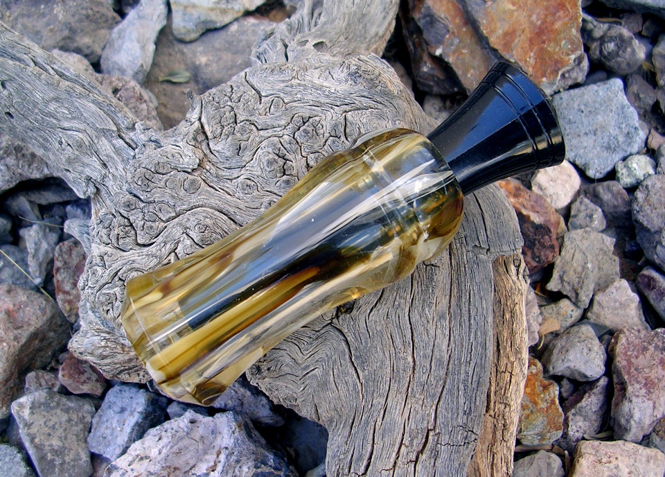

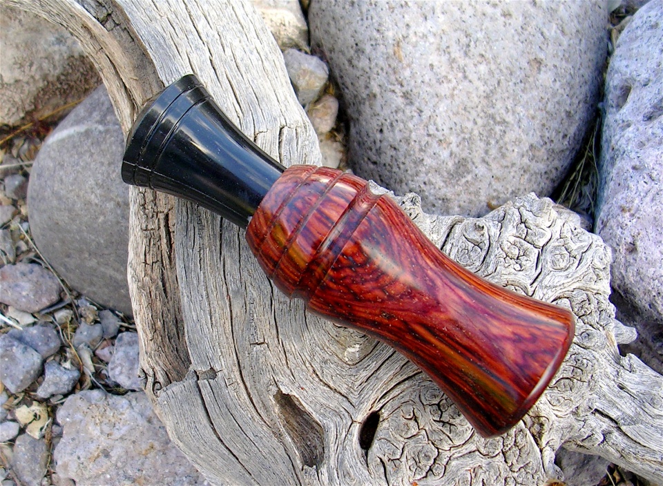

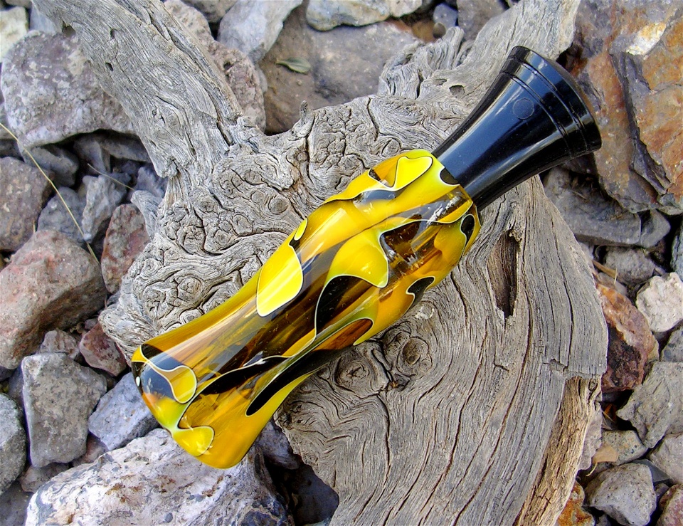

A few of the dozen duck calls I made this weekend for a friend. Seven were out of acrylic and the rest out of wood scraps I had kicking around. Just a friction finish on the woood stuff.
I had one reed section as a sample that I used for the photos.
Cocobolo, mesquite and acrylics.

Pretty wood is hard to beat, I could stare at the cocobolo call for a while. What friction finish did you use?
jjjaworski
Feb 22, 2012
914
Las Cruces, NM
Warren,
I used the shellawax products for a finish. I used the EEE first to improve the finish and then the shellawax friction finish. It is a no brainer and pops the wood color.
I agree with you on the cocobolo. It is a great wood for calls because of it being naturally oily. I got a lot of it here at a great price sometime back from an IAP member cleaning his shop.
