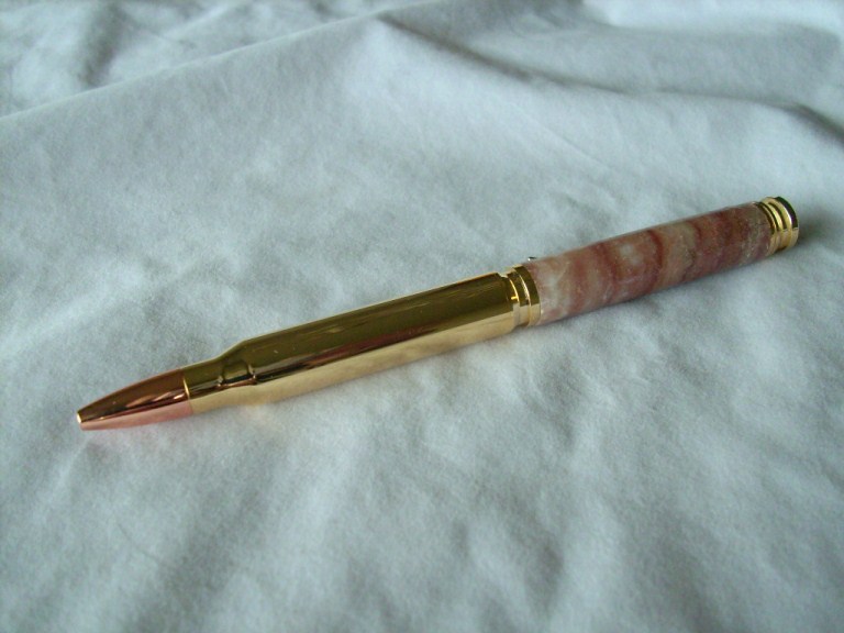

I did a CSUSA bullet pen in soapstone a few weeks ago...Never again!! YMMV, but I during drilling, spray a little water in the hole while drilling. 1/16" at a time worked well. I used a carbide tool with tiny cuts...that was the easy part. It finished beautifully and looked great!! As soon as I pressed the parts, the blank developed small fractures. I was able to run some thin CA over the blank even thought all the parts were on.
You might ream out the brass tube a little, or sand the press in parts a bit so you have to glue in the parts rather than press fit the parts. I think the hairline fractures are from the slight expansion of the brass tube.

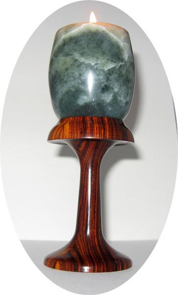

I've purchased from these people several times. I've been happy with what I received, but I'm no expert. They don't seem to have much in the way of soapstone at the moment but have some beautiful alabaster. Once in a while they have great deals on "grab bags". It is end cut and such. I have received some great stuff that way.
CA is you friend here. I put CA on all the cracks I see before even starting and as I go I add it. If chunks fall off they are easily glued back on. I don't make pens out of it (well I did one) because I;m afraid what would happen if it is dropped.
Save some of the "talc" you produce as you turn it. Make great filler for any cracks or voids you may have. I drill it on the lathe at the slowest speed my lathe has.
I've make a complete shaving set using it, including the cup to hold the soap. I love using it with wood, they go together well.
They are...the stone has no capacity for expansion So the first thing to give is blank
