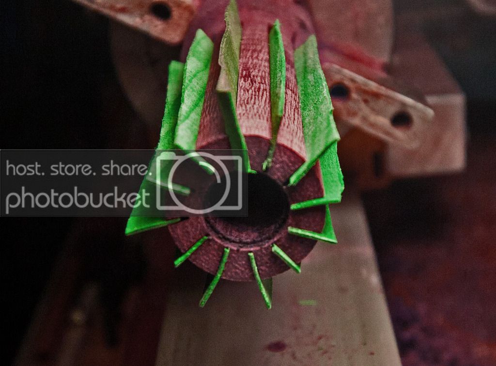

So what is wrong in this photo ?

another photo
The problem is not inside the purple heart fluted dowel .
The ridge inside was caused because I changed Forstner Bits
My first Forstner Bit that I used to bore the hole was dull.
Noticing that I changed bits, to a shaper Forstner bit but didn't know it would leave that ridge .
But that's not the problem that I am seeing .
A hint is the blade smoked going in.

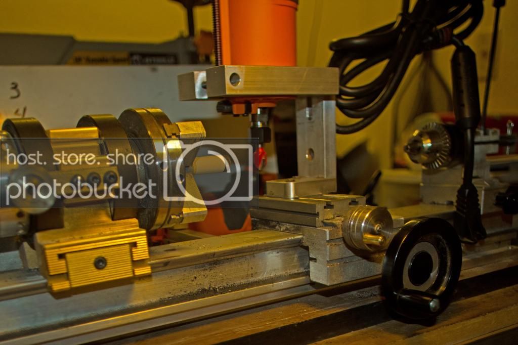

I have just switched from using a dremel to cut these slits or slots.
To using a Ridgid veneer trimer so I really don't know what normal is for these extremely small blades .
Here is a better view of the bore .
This going to be trim rings .
The fluted wood will be parted off into rings or washers ..
The issue is with the cutter

A winner
Looks like the saw blade is on backwards
Funny how pouring over pictures shows things we had not seen with out naked eye's and how everyone sees something different .
I can believe I got that clean of cuts with the blade on backwards ..
Cant believe I put the blade on backwards :frown:
Good eye Mr jjjaworski

Well I will stay away from all the obvious because this is not your first time doing this. I am sure you have cut these using this saw and cutting the exact same way before.
With that said I still say it is the blade of that saw. There is no set or such a small set in the teeth to clear debris when being cut. If the blade is sharp again an obvious thing. I get this all the time with a scroll saw blade. The amount of teeth turning in a tight slot creates heat. If there is any stress left in that piece from not being totally dried it will close around the blade even more so. If you have done this with this wood before have you had the same problem??? If this is the first time working with the wood this is what to expect.
You are showing so many other pieces cut and filled I am not following what it is you want to know. You obviously have done this before just from the other photos. Did the blade smoke in the other examples???
Wow well you answered in your last post. Good luck and that one is on you:biggrin::biggrin::biggrin:

Believe it or not but I thought the blade may have been on backward because of the swirl pattern on the blade. I know, it's easy to claim that after you provided the answer. I watched my grandfather drill a hole through metal with his drill in reverse one time, I have been acutely aware of the direction of rotating tools ever since I heard some of the words that came out of his mouth almost 50 years ago once he realized what he had done. Big impression on little ears.

The blade is on backwards to the feed direction. Shucks, I have done that on a table saw before!
Ahh, I posted this from seeing page 1, while the answer was on page 2.
How do you know what is the feed direction. As I shown in his other picture the blade is the same way.
If he started the cut from the open end and wet toward the headstock than yes. If he started at the headstock and worked out then it could be the other way.:biggrin: Now this is with the router on the side of the work piece as he shows. Put it on the other side and all reverses. Having fun yet.

The answers are obvious from the picts in posts #3 & #11 AND the "smoke" hint. Smoke can come from a number of reasons, but the most obvious and common are reversed blades. I learned that in EXPERIENCE Class 101 and Class 101R (remedial). :biggrin:
Yes, there are many "possibilities" but in reality not many probabilities (just one). I made one of those pens in 2007. Believe me, all possibilities are still in my mind. To me, Probabilities and possibilities are on opposite ends of the spectrum, with "probabilities" being reduced to one, when accompanied by such picts and the hint of smoke. :biggrin:

The blade was spinning clockwise, and the blade was on the wrong side of the blank so the teeth weren't actually cutting?

It's hard to tell on my monitor screen, but are the blade and arbour off vertical, so that the blade can't make true perpendicular cuts to the axis of the blank? If so, how are you holding the arbour - what fitting does it have, MT, R8, a chuck?
