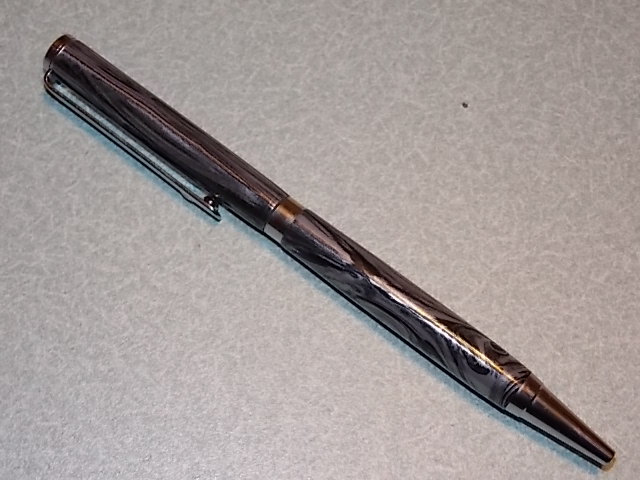

Here is an old picture of a pen that I made using a 3/4"x5" m3 metal pen blank.....
Still think that this is too expensive to work with??
What do you think that it cost me to make this out of a 3/4"x5" m3 metal pen blank???
It cost me only about $12.

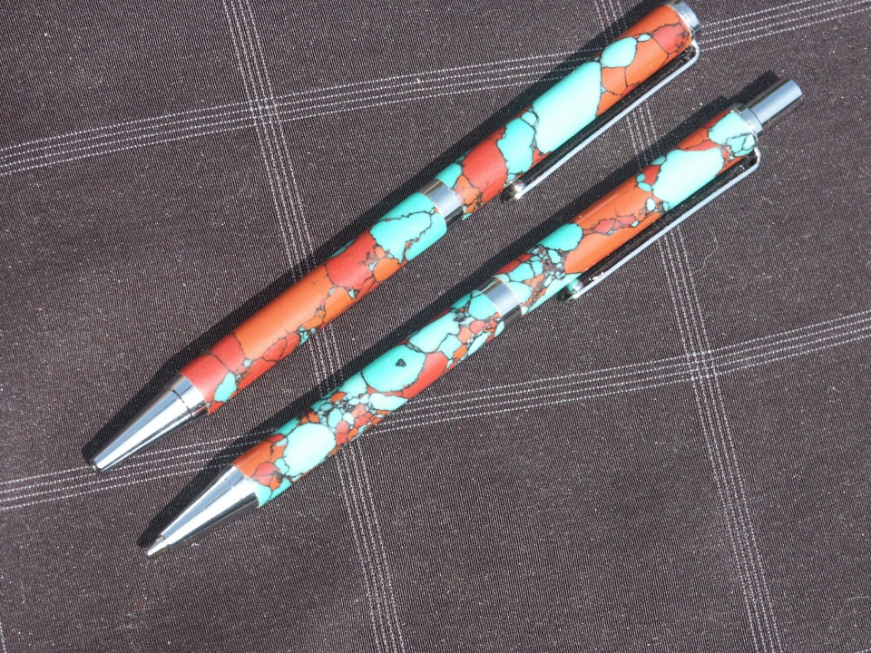

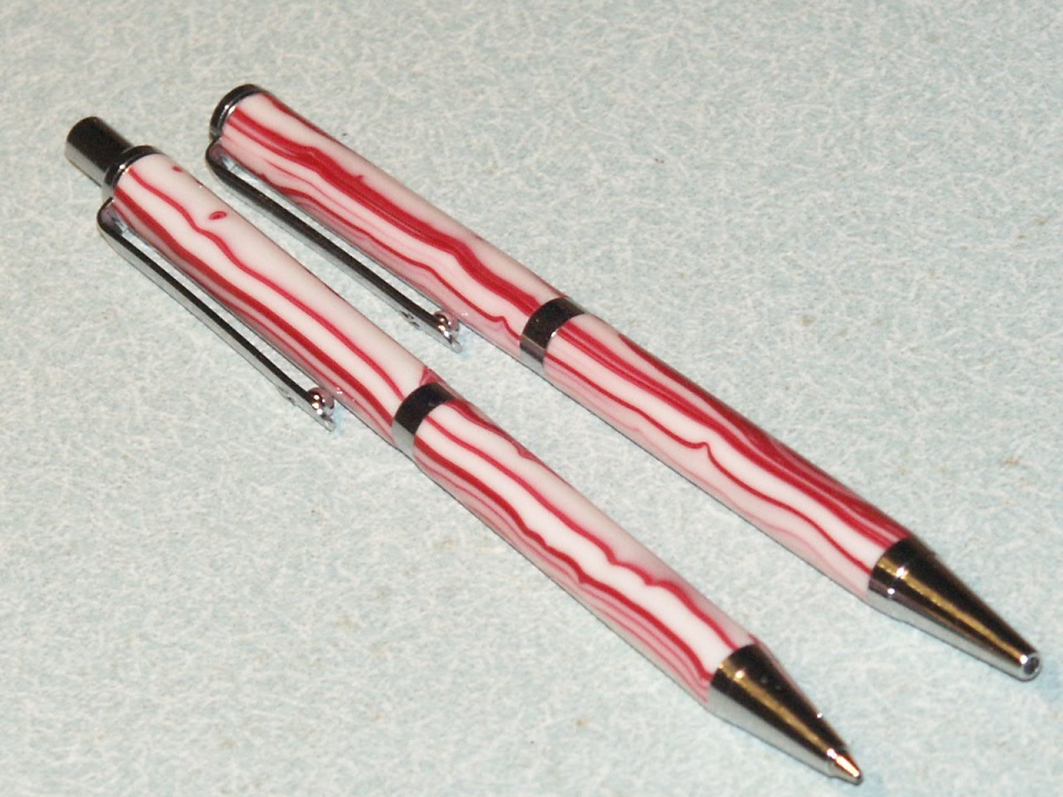

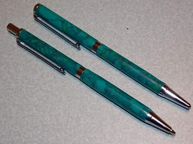

Here are some pictures of some pens and pencils that I made using 3/4" tru-stone blanks .
What do you think it cost me for the tru-stone for each pen or pencil???
About $4 each using new (not 2nd's) 3/4" blanks, I believe That bought them from Exotic blanks.
I bet they don't remember selling them to me that cheap....
The truth is that I make two of these pens or pencils using one 3/4"x5" pen blank...
using one blank allows me to get a perfect match for a pen and pencil set.
Anyone want to know how I make two of these pens or pencils out of one 3/4"x5" pen blank???
I am in the process of making about 100 slimline pen and pencil sets. 200 pieces, using only 100 3/4"x5" pen blanks.
Want to see how I do it?
