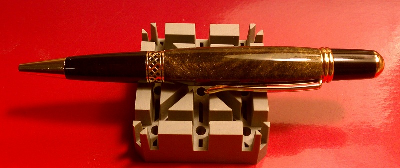

Attempt #2...
Took it slower with little bitty cuts. Used the 3/4 round gouge until I got back to the point about where I was before (1/8 or so from where I would've switched to sandpaper) and switched to 320 grit to get the shape done. Then 400 and 600 followed by MM. Much happier this time. :biggrin:
Thanks for the help!

Looking good ---
If you are looking for tool practice -- Make some pens for vets -- and turn 5-10 in a run. Your tool handling will likely get better prettty fast.
