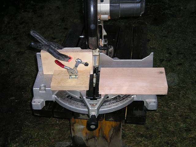

I will post a pic of a jig that I use to cut blanks on a mitre saw. I have cut 'thousands' of blanks without any issues. Only do this with the aid of this jig that safely 'holds' the 3/4" wide blanks as they are 'ripped' to 5.5" length.

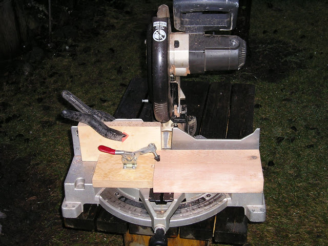

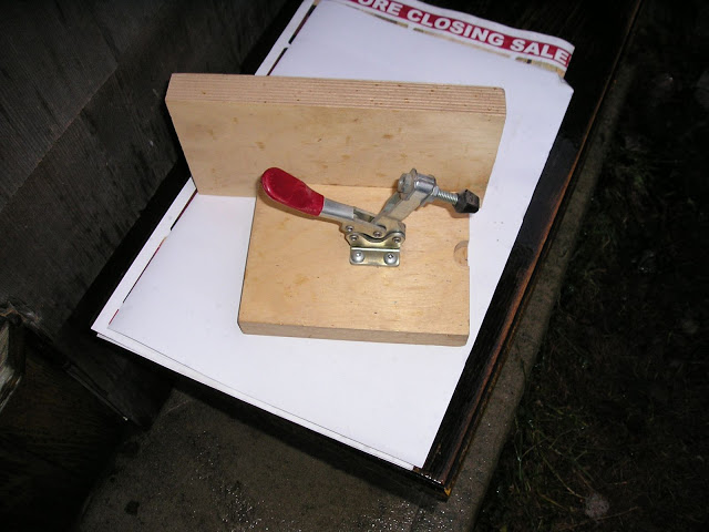

Allow me to show my jig and then comment for or against
I'd like to see that please.
Here it is, it's simple to make and 'safe' to operate. I usually set a 3/4" distance from the jig's fence and the blade of the mitre saw. The hold down clamp will hold the pen blank securely and prevents any 'kickback' from the rotating blade.

That is an interesting jig for cutting 3/4" blanks cross-grain.
What most of us think the original post was about was cutting a blank that is already 3/4" x 5" lengthwise down the middle.

If that is the case, then I misunderstood the original request. I thought he was asking if one could cut pen blanks to size using a mitre saw.
