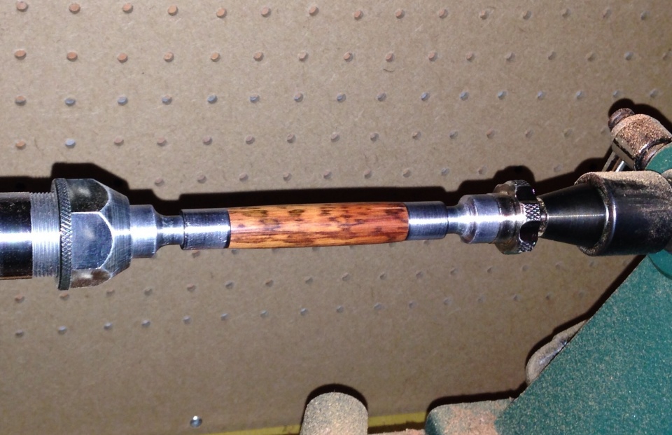

Pretty new to turning, only made a handful of kit pens so far but a few weeks ago I bought some snakewood.
I heard it was difficult to turn and not for beginners, but got it anyway thinking it would give me something to work towards.
Anyhow....couldn't wait and have it a go tonight - and it wasn't as difficult as I'd been lead to believe.
Turned, sanded and already has a real nice finish, not decided what to really finish it with - tempted to try a CA finish but also considering the basic laqour I've used on my other few pens.
I'm only making a standard Sierra with this one but have enough wood to make another 8 pens or so; so may be a little more adventurous next time.

the 'difficult' part about snakewood is keeping it cool and not over heating it. If you DO overheat it then it loves to crack and crack freely it does. It can be worked and it does look very good, just make sure it's very dry and watch that heat.

Thanks - I'd heard about it cracking and the need to make sure it doesn't overheat , but have to say it's worked like a dream so far, a little more sanding and apply a finish and all done. Mind you my garage was freezing cold!

I like your choice of hardware for this wood. I see a lot of beginners turn a really nice piece of wood and put it in a $1.5 kit and I think to myself why. This will be a beautiful sierra. Nice job very good choice of hardware the ability to add a very high end ink cartridge..
