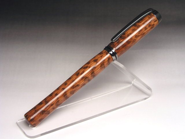

I finished a sierra with a very expensive piece of snakewood last fall. I have been reading about this wood cracking often. Because of this I held the pen back from trying to sell it giving it at least 6 months to set. Well its been 8 months and I went to put it out at a show this weekend only to find that it had indeed cracked. Does anyone know why this happens to this wood and what if anything can be done to prevent this? I also had an ebony wood baron starting to crack. I noticed it as I prepared for this show. Is this common as well?
