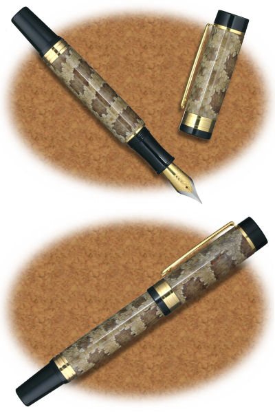

woodpens
Feb 15, 2004
894
Webb, AL, USA.
The pen below was made by Richard Kleinhenz and is for sale in the Pen Gallery at Woodpens.com. Does anyone know where these blanks can be purchased besides Ryan?
