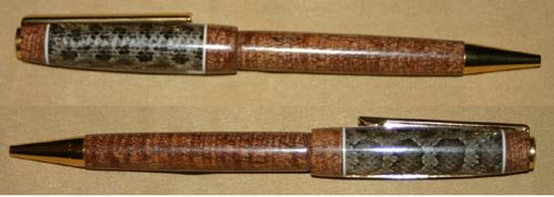

Here is a picture my latest snak skin casting. Comments welcome.

Polyester resin from http://mrfiberglass.com/polyester_resins.html
Silmar 41 Clear Casting Polyester Resin
Polyester resin cures quickly. It will be jelled in 30 minutes, hard but pliable in maybe an hour or so. I pour them in the evening, demold the casting the next morning, and cut up the slab into individual blanks that evening. I have cast and turned a pen the same say. More catalyst will harden quicker but the cast will be brittle. Less catalyst cures a little slower, but produces a better product IMHO. I'm turning a pen from one of the slimline blanks now and maybe a picture later this evening.

Originally posted by Charles
<br />Looks Really nice. Is that just clear casting resin? With a mold that size how long did it take to cure?

Did you use a pressure pot?
Which pens are these casting going to be used for?
When preparing the blanks for the skins is there a certain diameter under the finished pen diameter that should be held so the skins wont be turned away or cut into when finishing them?

Don...Did you use corks to keep the PR out of the tubes? Is that what I see? Did it work under pressure and were you able to pull the corks out or did you cut them off and drive them out.

John,
Corks is what you see. They have worked three times for me and three times for Jay...100% success..not a drop of leakage into the tubes. They are not salvagable. Cut them close and push out the other end. What a find![:D]

myname1960,
These you see are tubes for 1 each gent and baron, two sierras, and 3 slimline tubes. I make slimlines with snake on top and wood on bottom. I don't like slimlines with snake skin on top and bottom.
They were cast under pressure...40psi
To answer your third question, I try to make pens whose wood thickness is greater than the skin I have to work with. Thin walled (finished wood thickness) pens have not worked for me...such as the El Grande and Ligero. The baron has been good, the cigar works fine, slimlines cut fatter than normal work as does the jr gent, and jr statesman. This will be my first gent. Search the suppliers who sell snake skin blanks and see what they are selling. Those are the ones that the guy who makes them thinks will work. The blanks for the El Grande are offered, but I have not had any luck at all casting them. I will try again some day.
Here is a picture of a slimline I made this evening from one of the blanks in the cast I just showed.

Really good Don, I see that you choosethe 40psi I leave mine for 10 minutes and woork well, but now run out of tube and Barons, I turn the last one yesterday for my daughter Birthday next month, tell me how many bottle of wine do you have to drink for all those pens[:D][:p]

Thanks Serge. Jay has dropped the pressure to 30psi (I think) and it worked great. I usually cast in the evening and just leave them alone, but I have romoved the pressure after 20 minutes or so and all was fine. As soon as the resin jells the bubbles will be kept small. I really like what we are onto with this pressure thing. I hope your pot arrives soon. Don't think Anthony has received it yet from HF.
