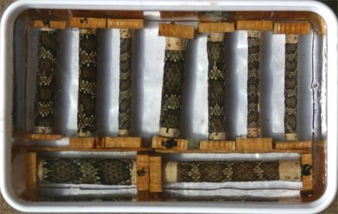

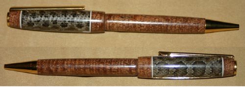

Did some more snake skin cast Saturday. Here is a picture of the casting and the first pen I made from one of the slimline tubes. The other pens in the cast are gent, baron, and sierra. The wood on this pen is black mesquite from S. America. Enjoy and comments always welcome.

Don,
Another fantastic example of snake skin pens! I really like the way the black mesquite accents it. What is the white accent?

Thanks Don and Ron. I hope some details may be coming soon. Ron, the white accents are fiber washers available from Woodturningz...unfortunately for you they only come drilled for slimlines. I've tried to drill the hole larger, but haven't had much luck. Maybe someone else has. They come in white, black, red, glue, green, and orange. I really like them for applications like this.

They are about as thick as a credit card...togh, but brittle. As soon as the bit hits them they split in half. Havent tried a punch, but as brittle as they are, not sure a punch would work. Sorry to hear the black ones have been removed.

Have you tried the pickguard material that woodturnerscatalog carries. Its a type of plastic laminate that is used like this in making pens and other items. If you havent seen it here is a link to the page its on.
http://www.woodturnerscatalog.com/cgi-bin/shopper?preadd=action&key=455-0100
Maybe this will work as well. I know i wanted to get some of the rings that woodturningz has. Maybe i will still order it and see if a punch will work.

well done as usual, is the snakeskin only in the pr or does that include the washers and/or wood?.
I have used some of those washers and I have had success using my press and a tube the size you need, beveled for sharpness, to create the hole size I need. Hope that does it for you.

Don...I really like the way that turned out. Did you use a euro tube on the lower end to make it longer? I think you have found to secret on casting skins. Very nice!!

I turned the blank (skin under PR from end to end) round then parted off the resin and skin from the ends and added the washers and wood. Thanks for the tip on the washers. I've only tried drilling them. I'll give you method a try.

Thanks John! I did use a euro tube on the bottom. I like the longer lower tube on the slimlines. I have glued in two regular length tubes and let them meet in the middle and cut off the exposed tube ends.
