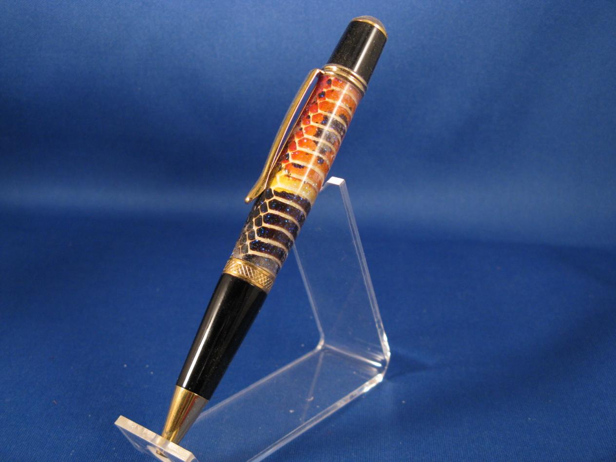

If you can find the coral snake skins, they do make a pretty pen, but they are small. The 12" rattlers would be a bit small, you might want to try them around 3 feet long. Some rattlers make better pens too.

Here's the problem. The state of Texas and some others have designated the coral snake an protected species. That means that trade in these skins is illegal. Their range is Southern Texas, Louisiana, Arkansas, Mississippi, Southern Georgia, and Florida.
To date I have had 6 skins. After the first one hit the web the others were sold when I got the skins. I have a standing order for any available and will pay GOOD money for them if they are pen making size. The largest I have had was 3.7 inches by 41 inches and it was perfect. Every bit was usable. I paid $250 for it.
Right now I have over 30 people on a waiting list for that pen and get about 1 inquiry a week.
Someone asked a while back if the ivory pens on my site were real ivory. Yes they are. The elephant ivory is legal and the pens are accompanied by a government tusk number and the date the tusk entered the country. The mammoth is not regulated and legal everywhere I know of. As far as I know you can only buy walrus if it is in the form of an craft made by the eskimos. I might be wrong on that. The only walrus I ever used was oosik.
Hope this will help in your search for the coral. By the way I am always looking for nice snake skins. I would like to have a green garden snake to see if it will keep its color after drying.
